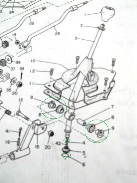

  8. Well I tried the tapping and bolting the shift collar. Easing the tap about half way through the tap broke. Now have half of collar being held by the broken tap. Any suggestions? I was thinking of drilling another hole and tapping it.
  9. How does the rubber piece at bottom of shifter come out? I have new nylon piece to put in.
  10. Thanks, a little more searching and I found the answer of taping and putting a 3/8 threaded bolt in it. Great forum for newer user.
  11. Trying to tighten up my shifter on four speed 85 BRAT. Wear seems to be shifter attaches to rod connected to transmission. I see a roll pin connecting to the rod. number 15 in image has the connection. Any suggestions for tightening this connection?
