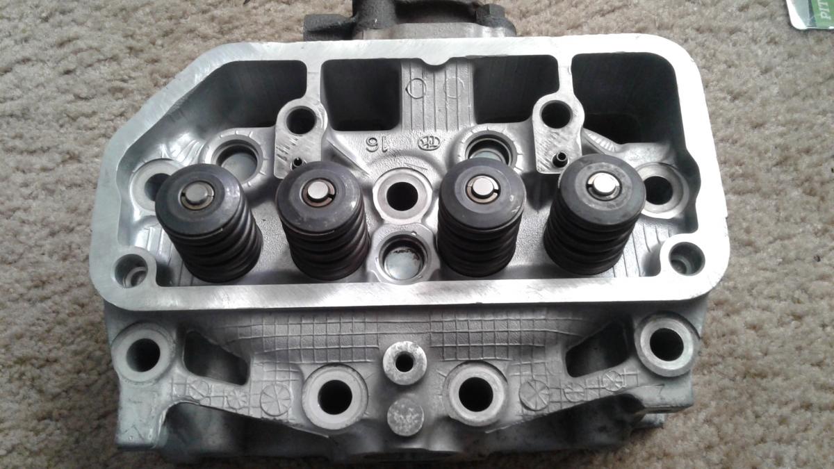

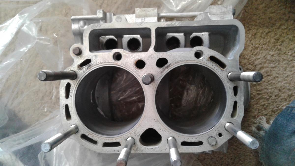

  4. The 81t had some issues, so i passed on it, this is the gl hatch ive been trying to restore, and do a coupke upgrades, looking for the passing lamp and grill, wanna get a tube bumper and winch, but currently have 2 ea81s on the bench, 1 jy for nuts bolts and stuff and the freshly clean cases and heads i am building, still havent found a d/r 5 spd without a million miles, so thats been a big hiccup
  5. Heres my builder. Also did they make a copper head gasket for ea81? Opinions?
  6. So additionally, what kind of clearance problems am i going to run into with decked heads? And my dad swears we need to go from hydro to solid lifters, any input on this? I know solids need adjusting which isnt a problem, but is there anyone who can tell me whats better for this motor and why?, what sucks is the heads have the valve in already, like the shop that shaved the heads put them together, but i dont know if they lapped them or anything. Pictures coming

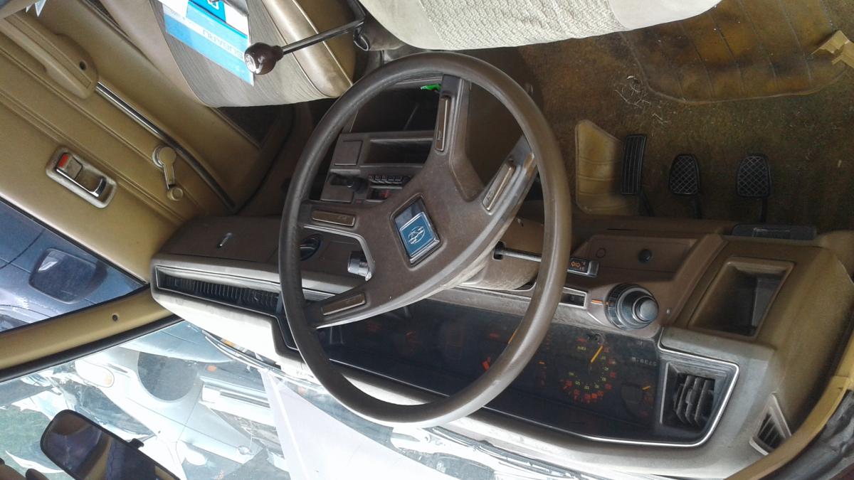

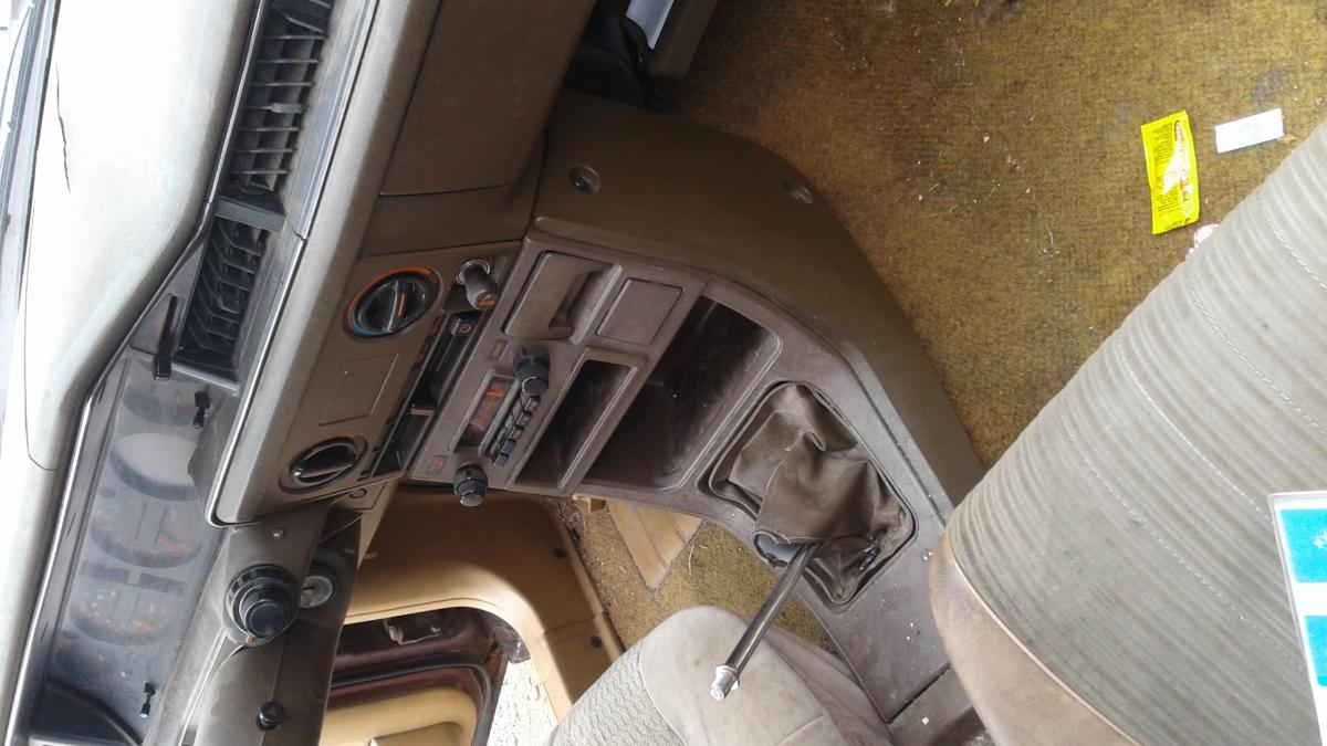

  13. Are you saying that grill would fit a brat or somethimg? That would look pretty cool.. there was a switch that said horn but didnt see city country anywhere, its pretty rusted tho, probably too far gone, and lots of dent
  14. Oh lol didnt notice, and same picture twice
  15. The radio thing and the steering wheel and whats up with the strange gauge cluster color
  16. It has the key in ignition, only one key so i believe original master key with full set of locks. And ignition. Tell me more about this horn
  17. Im not sure about the city horn thing, but heres pictures. Thinking of getting the grill to save from the crusha, 67k on the odo, looks like it was parked in a field for 20 years.

  20. So i bought my ea81 hatch for 1200, came running with 140k, a junkyard motor and a motor fresh back from the machine shop. Well cases and heads. Heads seem tobe shaved 20 or 30 thou, so my question is with the heads shaved do i need to have the crank and cam ground? I am thinking of doing the cam to 16/56, because ive read good things about that grind and my motor feels gutless as is. My dad has rebuilt many motors, hes teaching me on this one so forgive me if these questions are idiotic. I am looking for spfi pistons to put in. My other question isthe gasket kit, ive read different opinions on this, should i only go to subaru? Or use a standard one and get specifics from soob. Thanks for your time gurus
