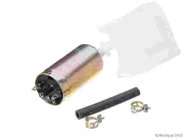

fuel pump shot? symptoms? repair?
RallyKeith replied to a post in a topic in 1990 to Present Legacy, Impreza, Outback, Forester, Baja, WRX&WrxSTI, SVXI already replied to the other thread including a picture that I can't re-upload to this thread. Fuel pump is a complete unit, there is now way to replace just the Motor. Pump is located in the tank, but shouldn't be hard to reach. There are access panels under the rear seat. Keith
RallyKeith replied to a post in a topic in 1990 to Present Legacy, Impreza, Outback, Forester, Baja, WRX&WrxSTI, SVXFuel pump is a complete unit, there is now way to replace just the Motor. Pump is located in the tank, but shouldn't be hard to reach. There are access panels under the rear seat. I've attached a picture of what the pump looks like. Keith
