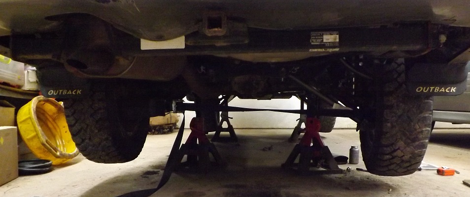

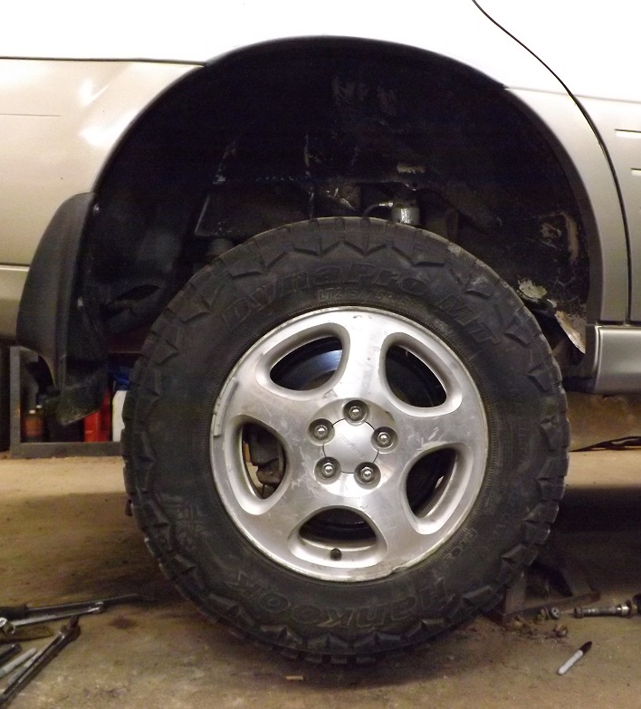

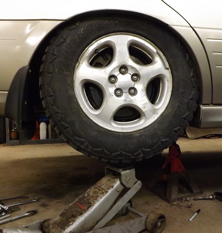

We did some mockup for more travel with the rear multilink suspension.  The limitation in droop is the inner CV bottoming out since most of the lateral links are much shorter than the axle.  Made some slightly longer than stock links to get a little more droop.  Here you can see it's a couple inches more droop than we had before (old on left, new on right).
Full droop:
Full bump:
This is 11-12" of wheel travel.  I need to get longer shafts and bodies for the shocks and make the longer links.  I'll also need to stick the top of the shock inside the car.  Thought about making a drop mount at the spindle but it's already the lowest point of the suspension.
Got a complete multilink rear crossmember/suspension/axles which helps to look at.  What's really limiting the rear travel (even with the struts) are the inner CV joints bottoming out since the links are shorter than the axles, the wheel pulls inward at droop.  Even if the CV had more travel, the links are getting pretty vertical at full droop and really pulling the tire in.  Thought about making longer links, which would probably require making a new rear subframe.
Some of the axles we've gotten have 30 degrees of angle capacity at the inboard CV.  If you had links about as long as the axles and plenty of body clearance, 22" of wheel travel should be possible.  I think the easiest way to do that would be a body lift.  For every inch of up travel you wanted to add, you'd have to add 2" of body lift with the same strut top mounts though, the compressed length of the spring/strut is going to be about 1" longer for every extra inch of travel.  Also at full bump the bottom of the wheel is about even with the bottom of the body now.  The tires get fairly compressed when landing so at some point you'd just start bottoming out on the crossmembers.  I already hit the front skidplate on the 1999 Outback occasionally on the face of a jump.
