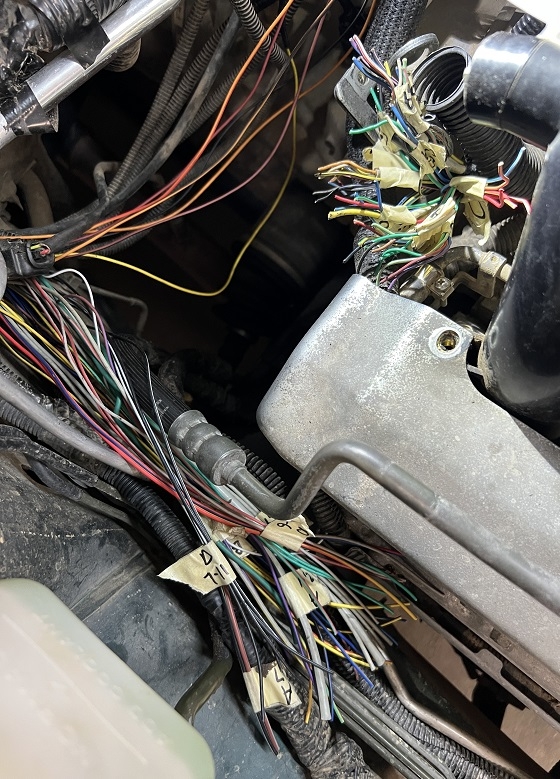

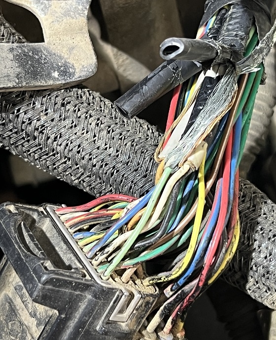

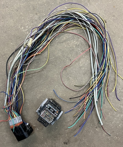

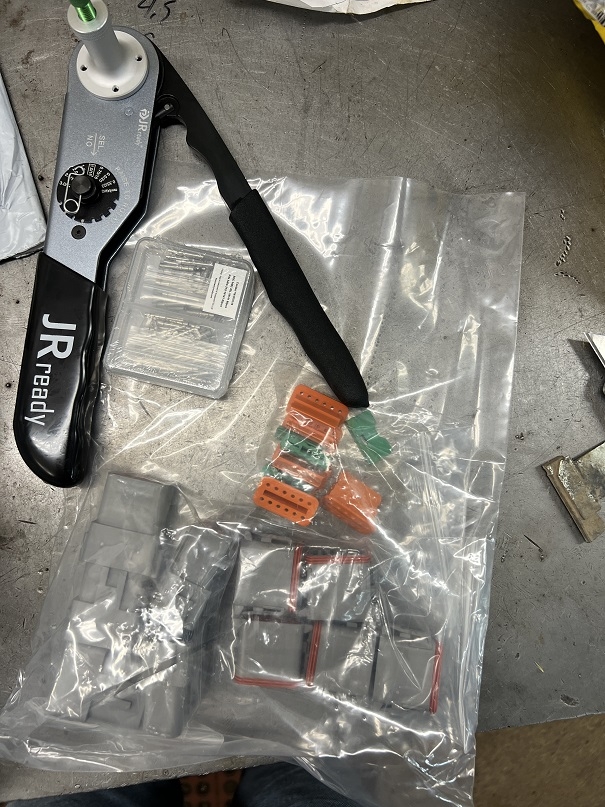

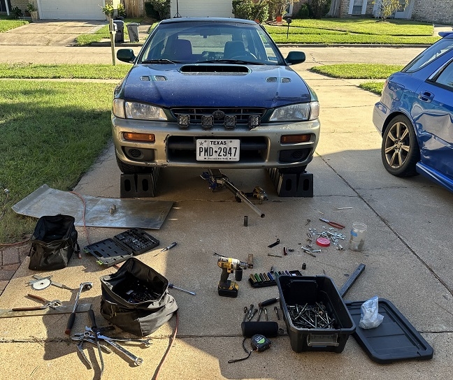

The Impreza has been taking a while to start fairly often since the swap after it sits overnight or longer. Sometimes it takes two or three tries before it starts. A while back I discovered this was because the crank position sensor wasn't generating enough voltage while cranking. Voltage signal on the Haltech oscilloscope looked decent but it wasn't enough. I lowered the threshold voltage and also added a column for 0RPM which seemed to help but still wasn't a complete fix. Then it just wouldn't start, was giving crank position and throttle body codes. I took apart the engine harness connector as that's been the source of most of my problems and the wire pulled out of the pin for the crank position sensor. I repinned that and checked the throttle body connections and it started and no longer had those errors but it was running rough, probably on five cylinders. I decided I'd had enough and ordered some closed barrel pin connectors and a tool from JR Ready. I'm not a huge fan as they're made in China and I don't like how closed barrel pins don't crimp on the insulation but M says they're the best thing they've found for wiring airplanes so I figure it might be good enough for trail riding in a Subaru.

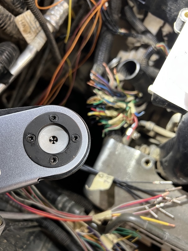

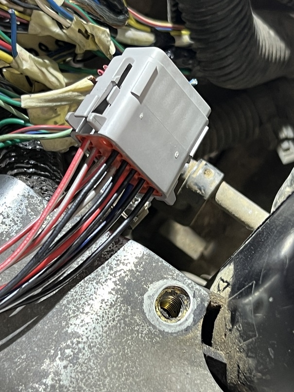

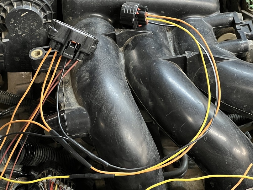

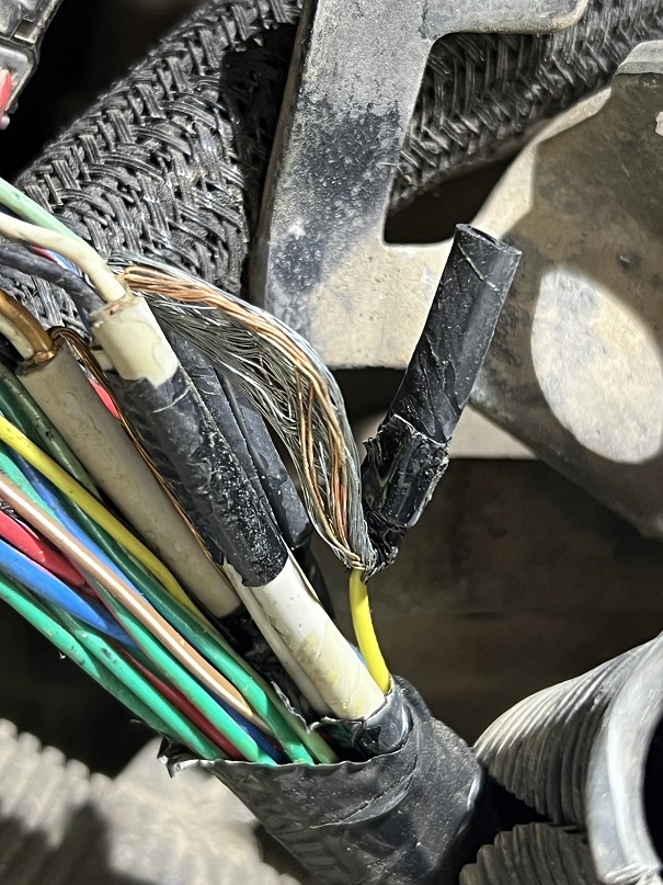

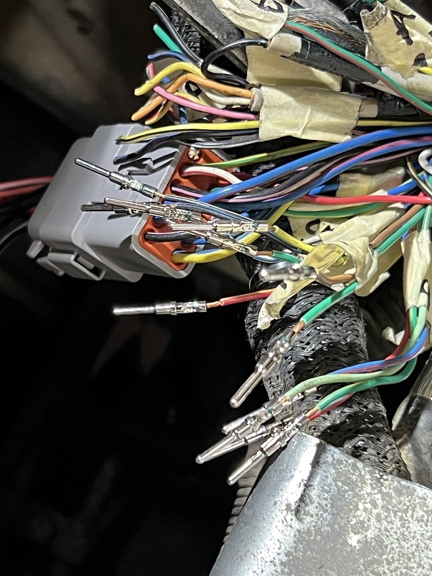

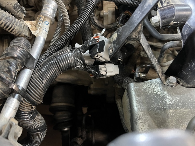

The week before we left I rewired the engine harness plug on the Impreza with some help from B. Shortened up the wires with a couple feet of excess length in the process.

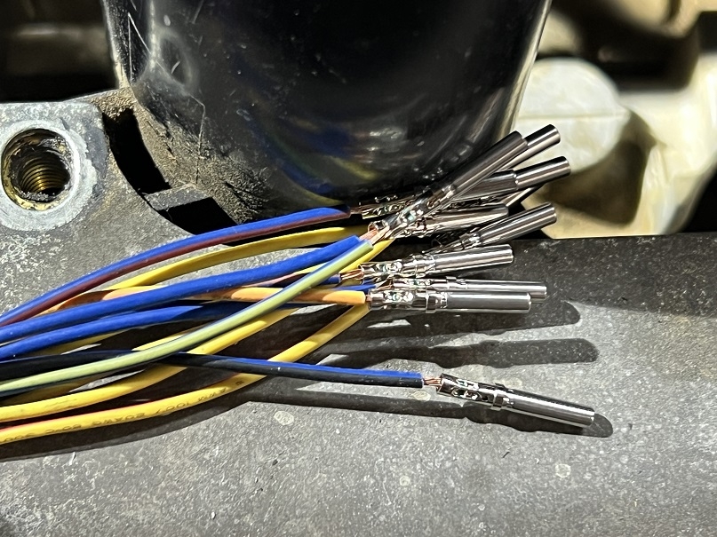

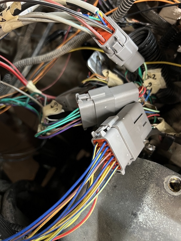

Directly wired the throttle body and MAP sensors to the ECU as they're pretty easy to unplug and then I'd have one less connection in line and fewer things to run through the connectors I added.
Added four Deutsch connectors with closed barrel pins.
I did zip tie them away from that bracket after I took that picture. Labeled and checked wires, pinned out the connectors, double checked wire color matches and tried to start the car Thursday. Only cranked but didn't fire.  I checked various things, sensors seemed to be reading except the cam and crank position sensors. Then I realized I hadn't plugged that connector in. Then it fired up. Overall pretty happy with how that turned out, should be much easier to repin those connectors and the reduced wiring under the dash makes it cleaner and allows the glovebox to fit better.  Bit of a last minute fix finishing that the day before we left but I'm glad I did it.

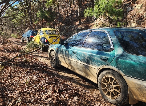

Did some trail riding there with travelvw mostly leading the way. Slammo and I both got to drive travelvw's bug.
It rode quite rough as he has much too large torsion bars in the rear.  He said the limited slip makes a big difference and it definitely looked like it on loose climbs, much less wheelspin than I would have expected.

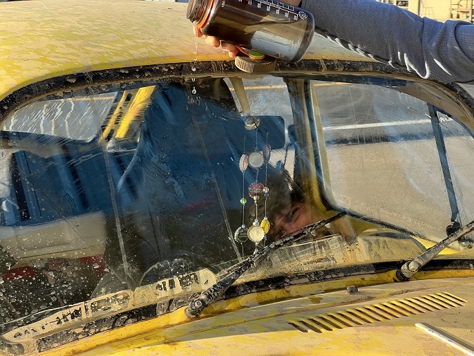

Travelvw's windshield washing technology:

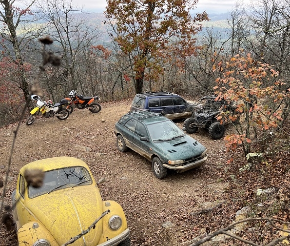

Near the end of the day we drove to the top of Eagle mountain. There was a rocky obstacle near the top that slammo left his car at the bottom of. B and travelvw were getting video so I took the most difficult line and put a hole in my RF tire sidewall.
We swapped on the spare and drove to the top.

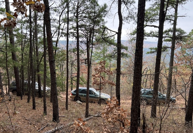

A little off to the side of the building at the top there's a nice rocky outcrop with a good view.

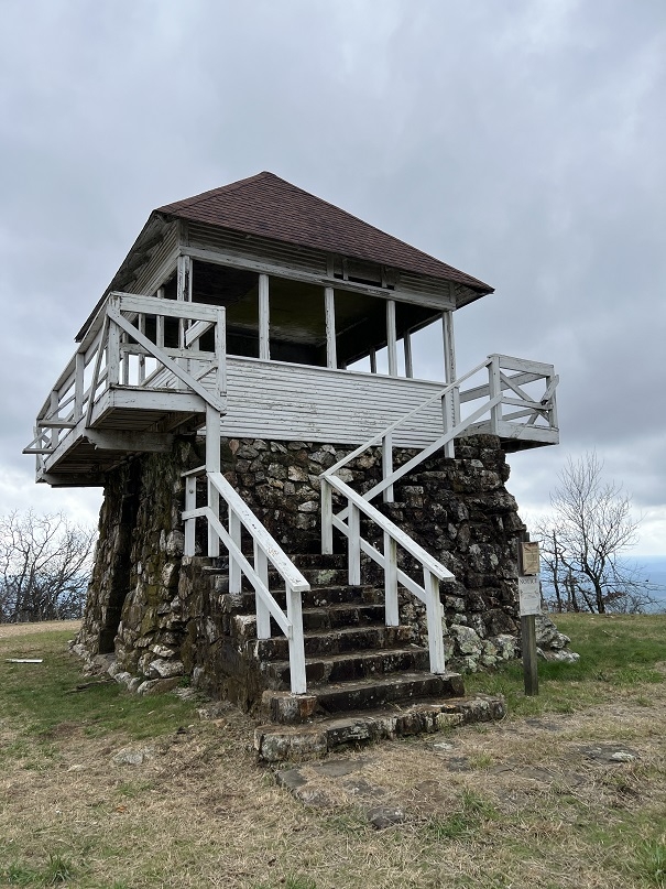

We headed east. Hiked to a couple different old lookout towers, one a much longer hike and also more intact than the other.
From the intact one you could see the hills/mountains generally run east/west.

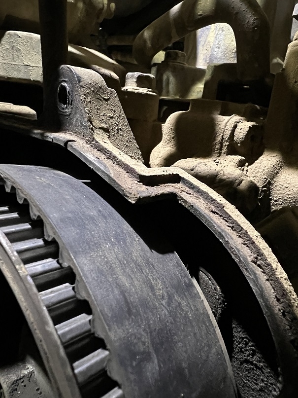

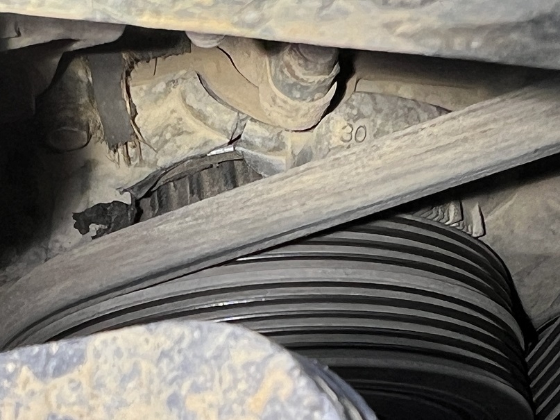

After that it was much more stable the entire ride home. B took part of the timing cover off at one stop and confirmed the timing belt was loose.
Didn't see this until after we got home.  It's been a while since I've worked on EJ engines but I don't think you're supposed to see the timing belt through the cover and that looks like the wrong side of the belt.

Yea, timing belt broken while running almost certainly needs most of the valves replaced. But they don't usually damage anything else
That'd be good.  A little worried it messed up a piston or bore but guess we'll just have to wait and see.  B dug out his best pair of heads, cleaned them up, and lapped in most of the valves this weekend.

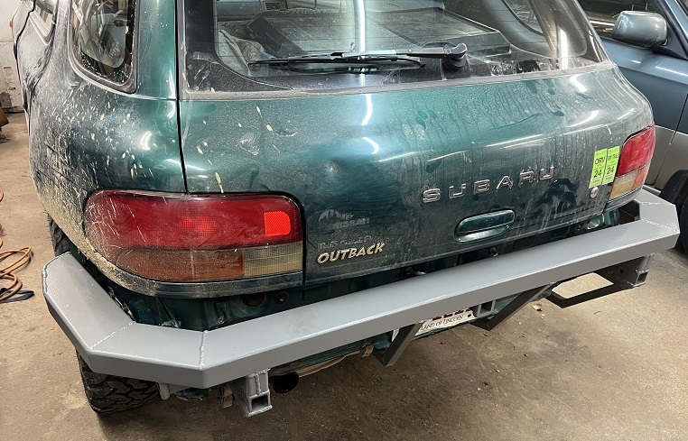

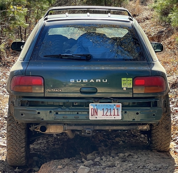

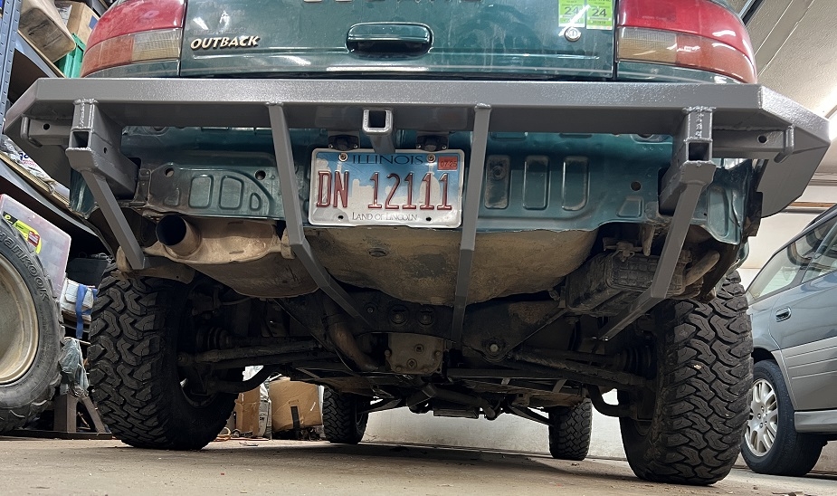

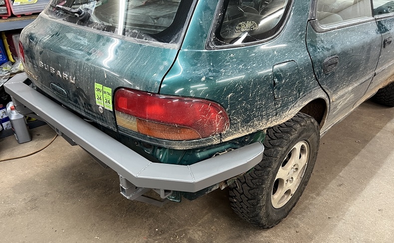

I worked on the tow bar a bit and installed the painted rear bumper on the Impreza.
Already got a couple compliments on it running some errands in town this morning.  Should make recovery easier.

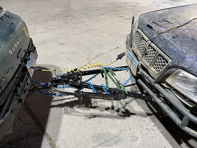

Not going to tell you it's safe to flat tow like that but it's plenty stable with a decent tow bar.  There's a significant number of people who will buy two (or three) vehicles at a time at an auction and link them together this way and drive them long distances.  We see them fairly often on our way to Arkansas in particular.  Most of them seem to survive.  Braking is obviously half (or less) normal so you have to be careful.  Towing with trailer brakes would be significantly safer.

Rear bumper looks sturdy, is that the same color as the front bumper?
Would be really nice to have a way to use the towed vehicle's brakes when flat towing, but any solution I can come up with gets too complicated too quickly.

Yes, rear bumper same gray color as front, roughly matches the bottom of the body.
Agreed on the towed vehicle braking.  Maybe the simplest would be to have an extra master cylinder plumbed in that the tongue would push on.  Have seen this on some boat trailers.  Could just have the extra master on a hose and store it somewhere on the vehicle when not towing.  Also have discussed wiring a trailer light pigtail into the front of each car so we don't have to use the magnetic lights.  But all of those things require a significant amount of work on all of the cars.

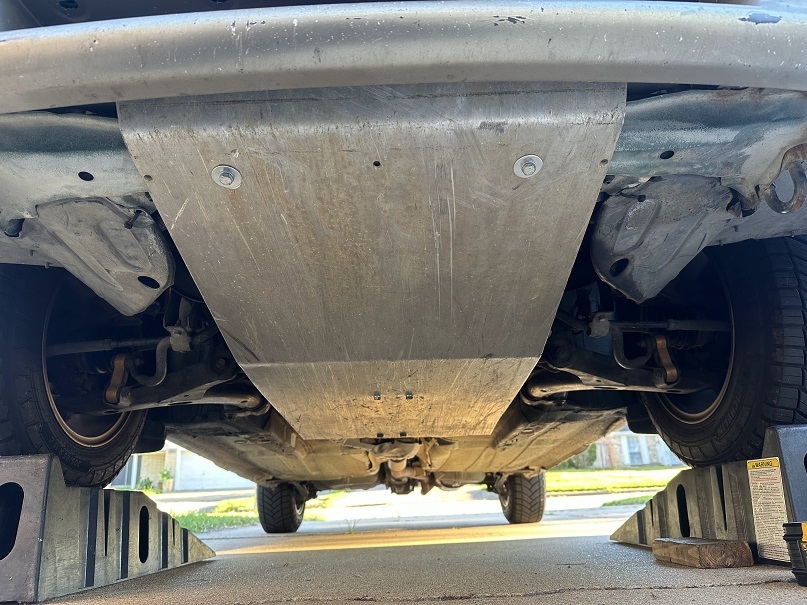

Turns out taking a stock-height Subaru off road can be pretty hard on the skid plate. Glad I wasn't trying to keep up with the long travel cars all weekend haha. Looking forward to getting mine put together soon-ish.
Edited by slammo

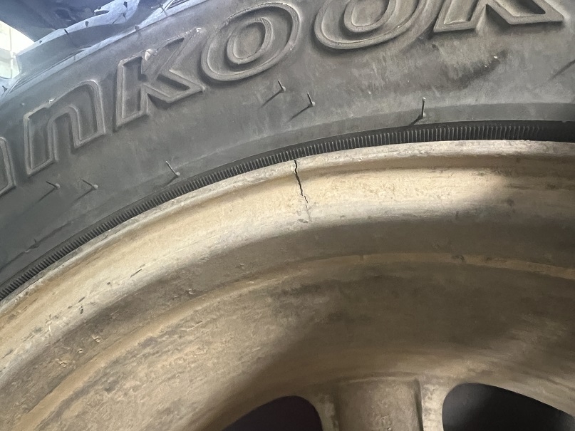

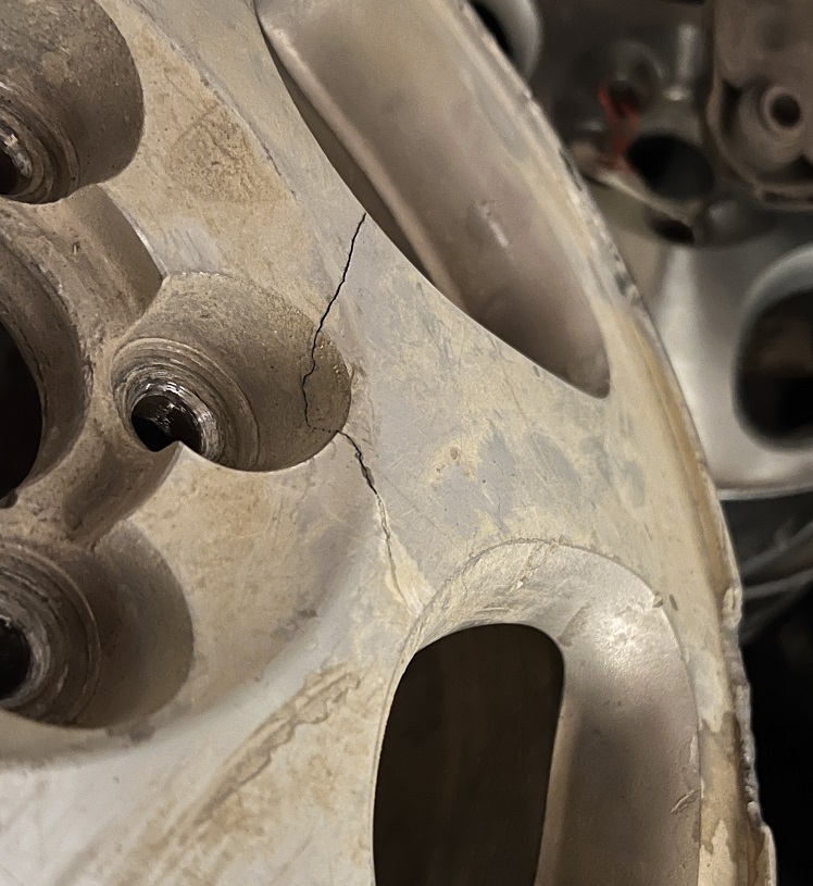

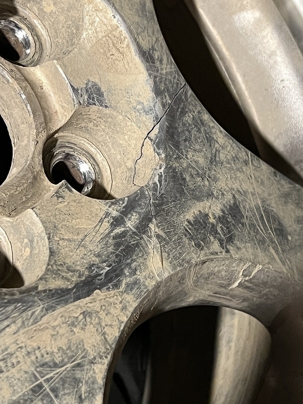

Got the tire with the hole in the sidewall replaced under the Discount tire road hazard warranty.  When I got the wheel back I noticed this crack through one of the spokes.
Not sure how we didn't notice that, maybe the tire machine opened it up a bit.

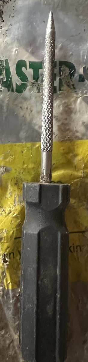

M stopped by to plug a tire on his wife's late model Outback.  He noticed my tire reamer is quite worn.  It's been used a few times.
