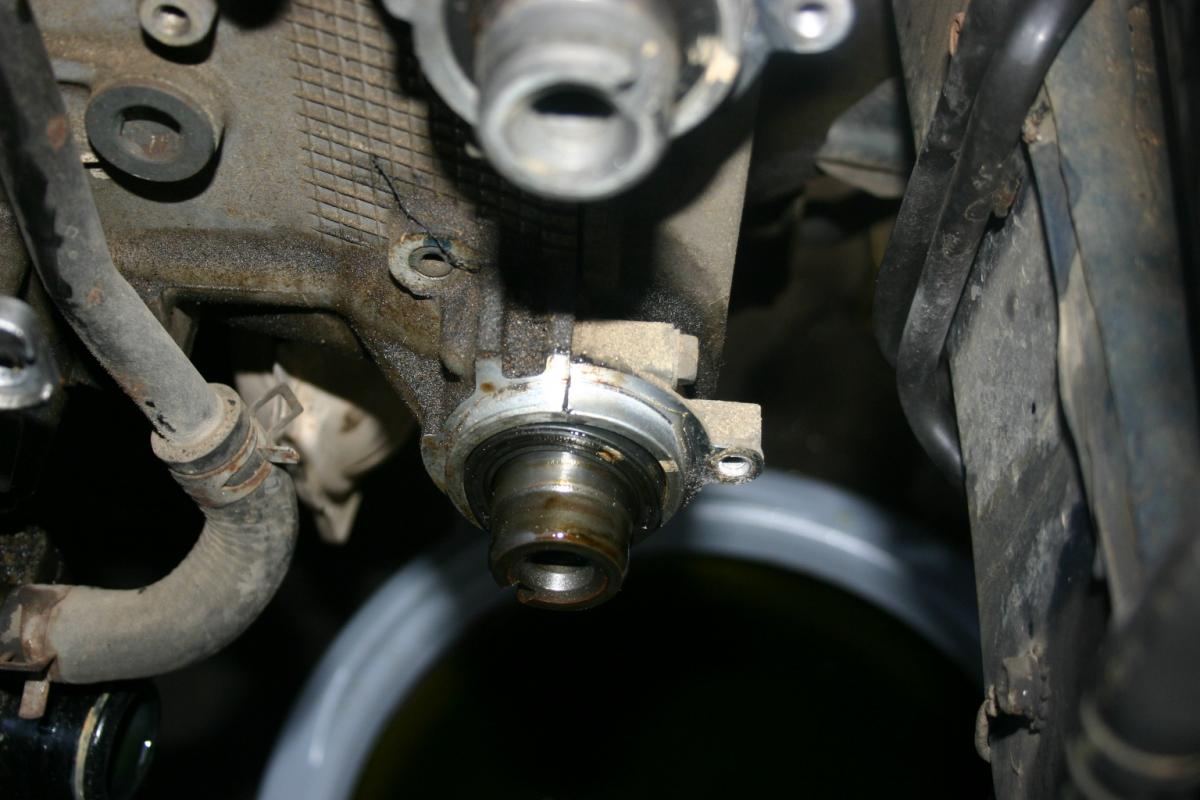

**my 1998 subaru Outback 2.5l auto with about 130k miles  popped check engine light.
-Drove it about 12 miles,  checked  fluids ( oil, Brake fluid, trans , coolant )  all looked good.
- pulled battery Cable to try and reset   light in case it was a one time thing.
-Reconnected battery, Started car , idled until temp guage started reading,  still check engine light.
-Turned off car  fluid check again . . . oil was way low, looked  under car, 0.5 + quarts dumped right under the car.  seemed to be  coming from Driver side left  of engine  above the lower Radiator hose  connection behind the plastic  cover that is behind the belts.

I'd take off the covers. May be just front cam seals.

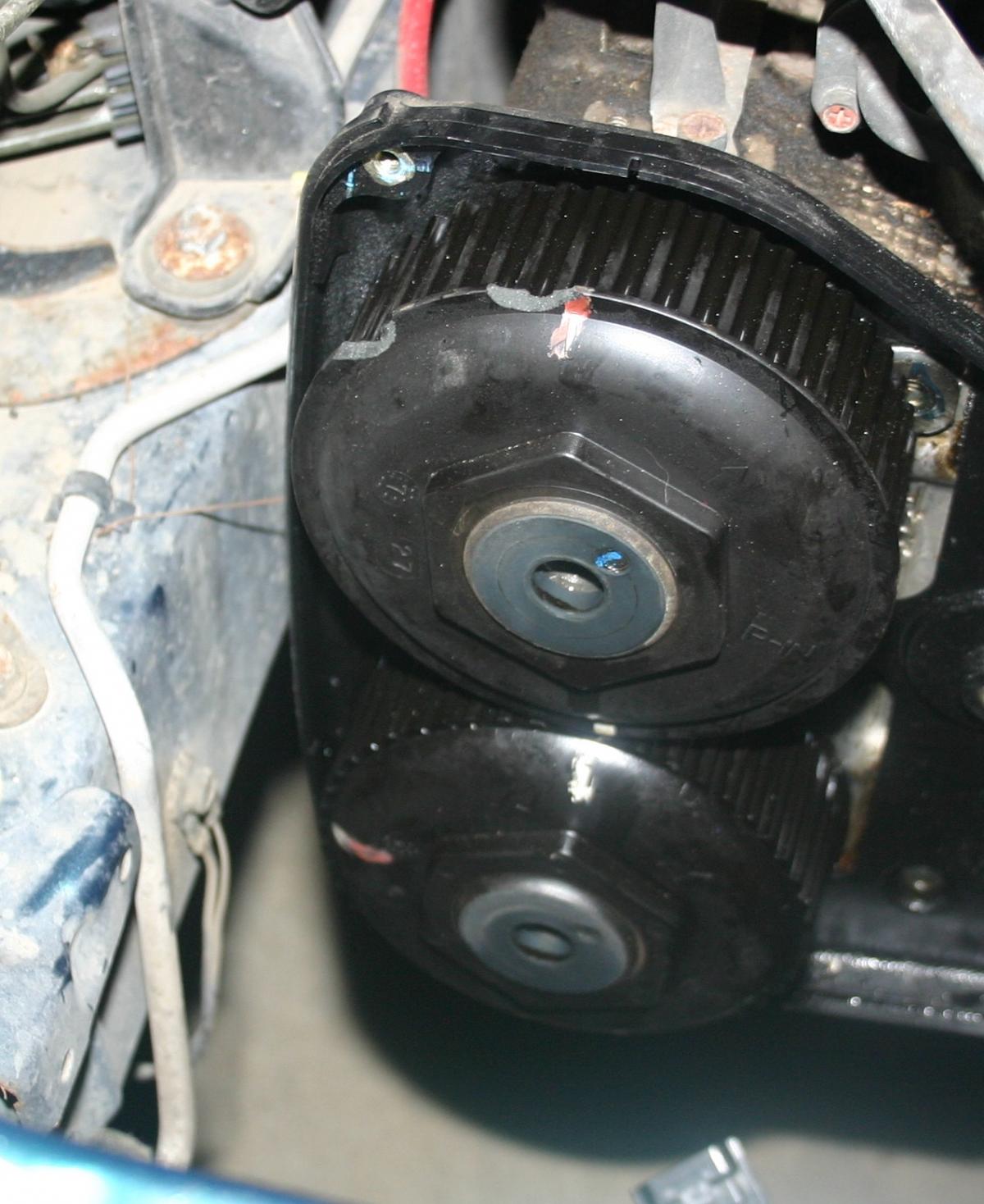

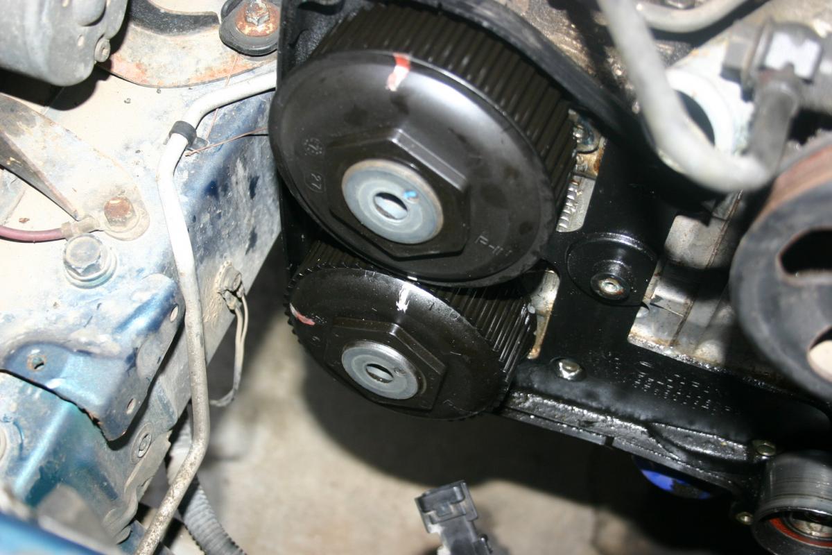

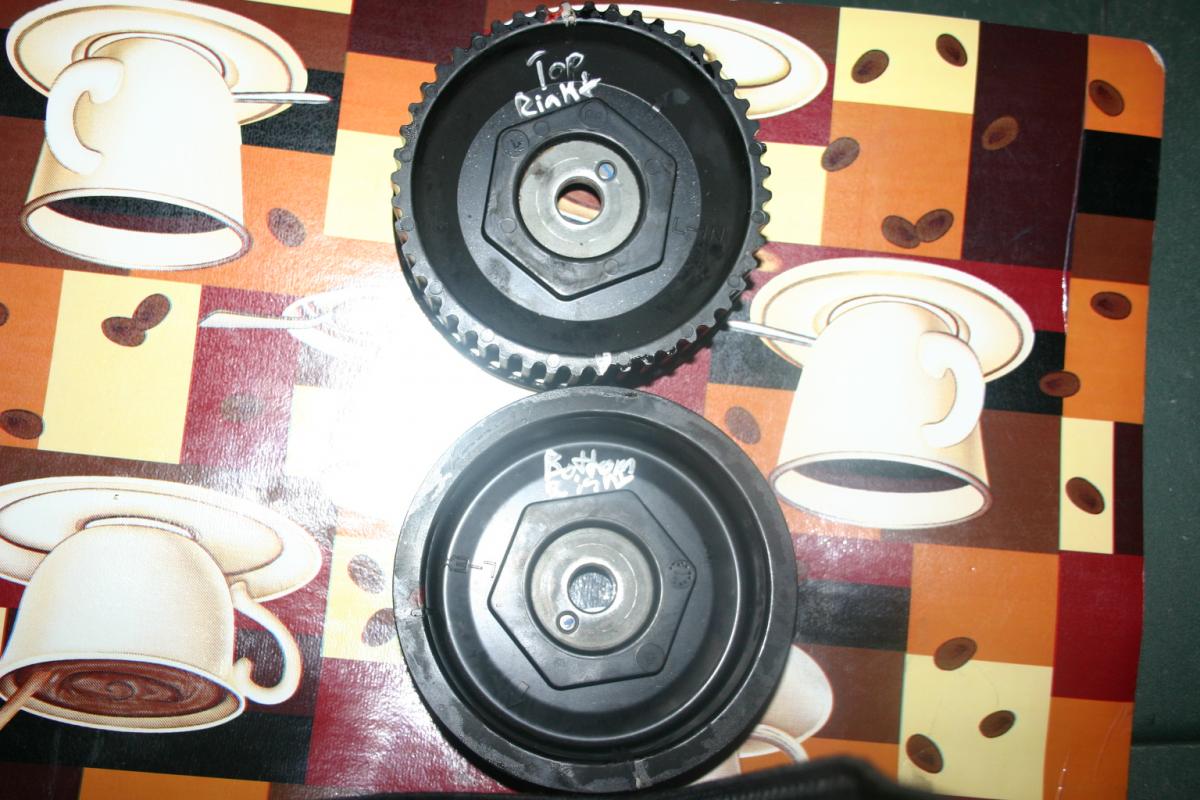

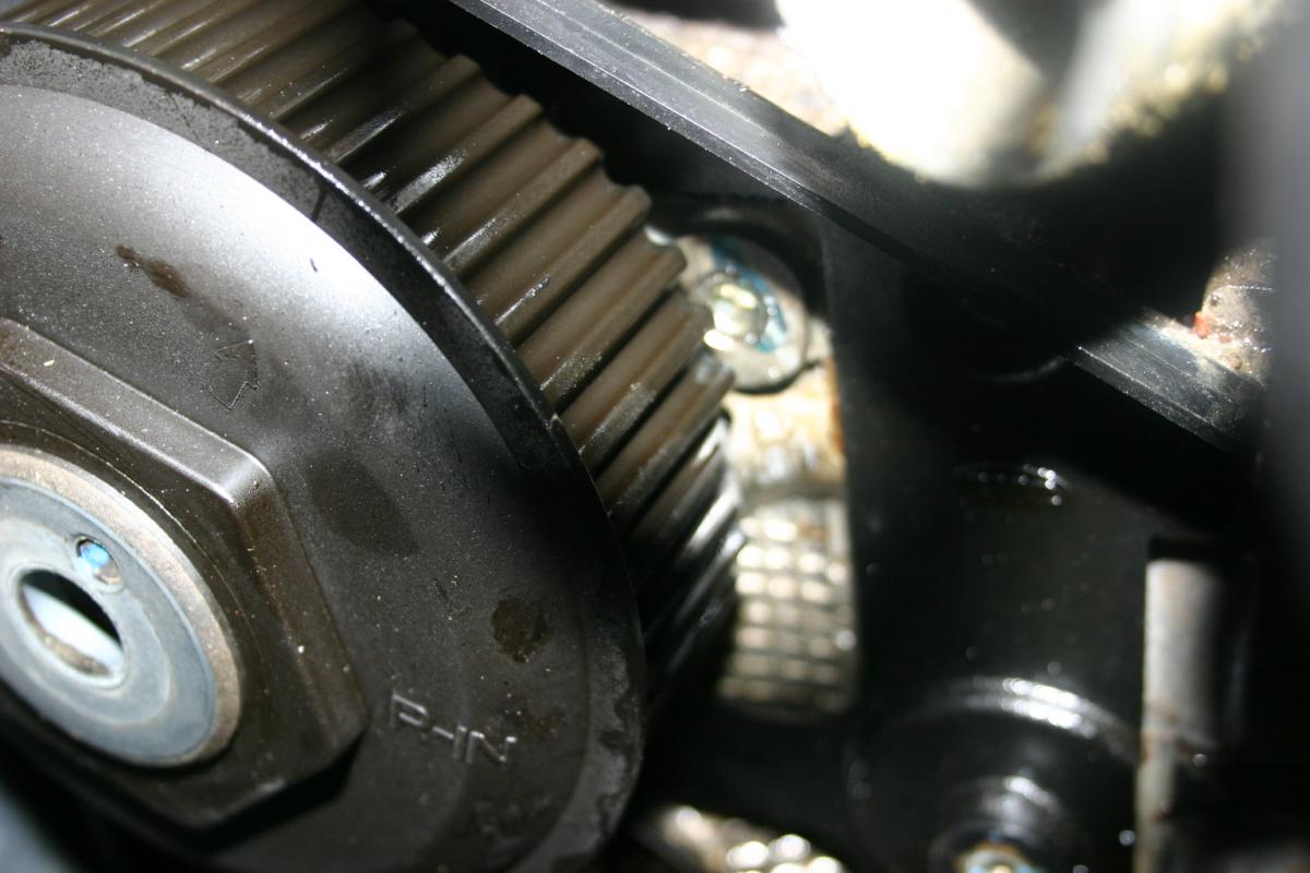

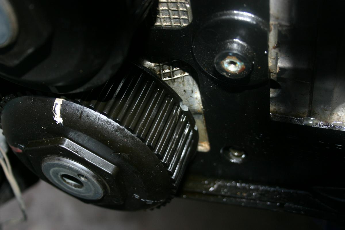

Before I start this one THANK YOU  to all helping me through this.
Just wanting to make  very  sure I have the cams in the correct position.
passenger side cams:  on the car.
Driver side cams: shown off the car in intended / current position
Does this look right ?  the driver side ones seem wrong to me :0/
Thanks again for any help / feed back!
Edit: just found this : subarutiming1Howitshouldbe.png  is it correct ?
Edited by legacy93wagon
