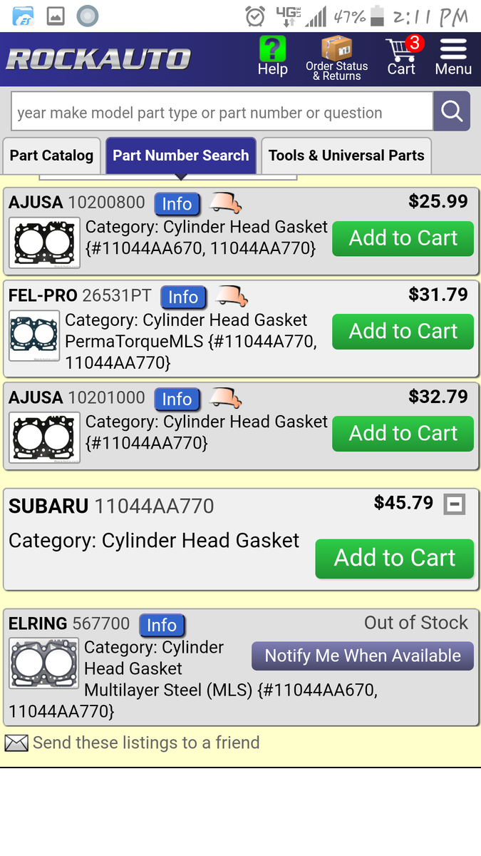

If i ordered from rock auto and use
Part number 11044AA770
Would those be ok to use? Or would i have to get subaru oem and use that part number?

Allegedly Rock Auto has the Subaru 11044AA770 PN for $46
Same PN from Subaru online is $57.
If the Rock Auto part is an Actual Subaru part then I would buy that one

If anyone has bought the subaru brand head gaskets from rock auto, please chime in and let me know if they are actually subaru brand head gaskets.

If rock auto allows you to enter the part number and cross references interchangeable parts for you - no that is not going to be OEM.  They include OEM numbers in tons parts listing for easy verification and searching but they are not OEm parts.
if you mean you enter the year make model engine and drill down to head gasket and Subaru OEM is one of the options then yes it should be Subaru.  They’re usually not cheaper than online Subaru or your local dealer if they give a discount so Ive never done it.  But I’ve seen them listed. Most of those listings even explicitly say “OEM Manufacturer” very clearly.
Edited by idosubaru
Rock Auto does not have OEM headgaskets (by drilling down, make, yr, model)
