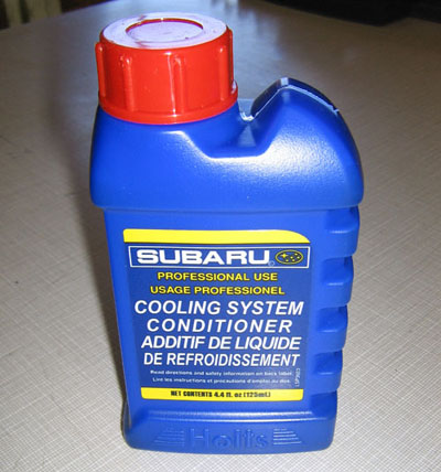

August 17, 200916 yr The deal with Suby cooant is that is has "certain" properties that add in keeping seals, and other componants I.E. head gaskets from failing as bad as they used to. Anything after 2000 gets it. Anything before 2000 you can use "regualr coolant." But I always add the suby additive to any of my customers subies, that involved the taking out a mass of coolant. In my 96 I run regular with the additive. With the 85 EJ conversion same deal. And like I said earlier any of my 2000 and above customers I put the suby coolant in. And FWIT I prefer the Toyota long life coolant over Dex Cool I can get the Toyota long life at Carquest for about the sam price as DexCool. I can definitly tell the difference with the Toy and Suby coolant as compared to "regular" green coolant. It smells different, feels different, pours different, everything about it is different. As apossed to DexCool I really don't see much of a difference between it and the green stuff.
August 17, 200916 yr Hey Mugs, what's this "subie additive" you speak of? What does it do and where do you get it?

August 19, 200916 yr Hey Mugs, what's this "subie additive" you speak of? What does it do and where do you get it? You get it from the dealership. It is supposed to aid in keeping things sealed up and keep things soft in conjuntion with the suby coolant. It looks sort of like stop leak but I think greatly improved to where it does not stop radiator cooling and heater corre heating Thats all I can really tell you. I add it as "butt covereage" for me, to my customers cars
August 20, 200916 yr Author Bar's Leaks, a stop leak additive that's been around for many decades uses ground up walnut shells( as I understand) as it's main component. I used it in a couple of Peugeots years ago. Peugeots were notorious for head gasket problems. The Bar's Leaks plugged up the heater cores of those two Peugeots. I've even used "AlumAseal" with disappointing results. The Subaru cooling system additive, however, is a far cry from Bar's Leaks ad AlumAseal. I've had it in my Subie's (2000 Legacy GT Wagon) cooling system for the last two coolant changes, about 60k miles, without any issues. My Subie's Head gaskets seem pretty tight so far, with no evidence of hot running, (knock on wood)even during hot summer days with the A/C on. Occasionally I need to add just a bit of coolant to the reservoir to keep it at the proper level. But the temp indicator always stays in the center of the gauge. So the Subaru cooling system additive appears to be working as intended.
August 20, 200916 yr Glad to hear it, Bluestone . Seems like a good option for some Subarus, but it also sounds like with the engine I have it's not necessary since the EJ22 2.2 doesn't seem to be prone to head gasket issues... (according to this thread).
