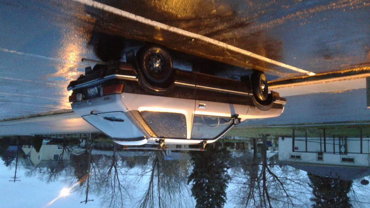

Trans mounts, the body side bushings on the sway bar endlinks, and both front axles again, bad trans mounts chewed my last axles in like 3k miles. Grrrr. Finished spfi, sent bratsrus my stuff for a 5 spd kit, and got one of those streetlight rainy pictures that make our cars not look like rust buckets
And apparently my gl sticks to the road even upside down, lol
Useful for driving in the Southern hemisphere.
