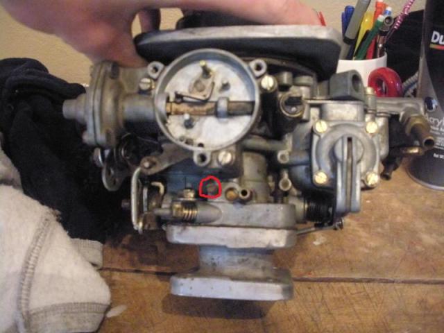

I Already wrote that to Him:
ya we decided that somebody must have converted it. i am curious though to the right of the electric choke, what is that other electrical connection?
Posted Image
so is that vacume port under the electronic choke for the pcv? seems a little small...
There should be Two 3/16 Vacuum Ports in the Weber's Front, the one at the Right is for the Distribuitor's Vacuum Advance, the one at the Left is for the EGR.

ok so if there is only one like in my case then can i tee the vacuum advance, or should i just use one of the other many unused vacume ports on the intake for the vacuum advance.
Posted Image
The circled one is the EGR port. Remove the screw and attach the hose from that to the EGR.

ok so if there is only one like in my case...
No, your Weber has Two vacuum ports in front, but the one on the Left is Closed with a Screw, as Subynut already wrote; you can remove that screw to use it on the EGR.
...or should i just use one of the other many unused vacume ports on the intake for the vacuum advance...
Never use a Vacuum port in the intake for a Vacuum advance on the Distribuitor, because the Vacuum provided by the Carburetor is somehow "Progressive" and the Vacuum Provided by the intake is "Permanent" and will be too Strong for the Rubber on the advance and could damage it... also since it is permanent, you'll Loose the Advance feature and the Ignition Timin' will be too much advanced.
...can i tee the vacuum advance...
Nope, is not necesary.
Kind Regards.
