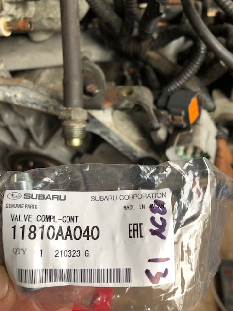

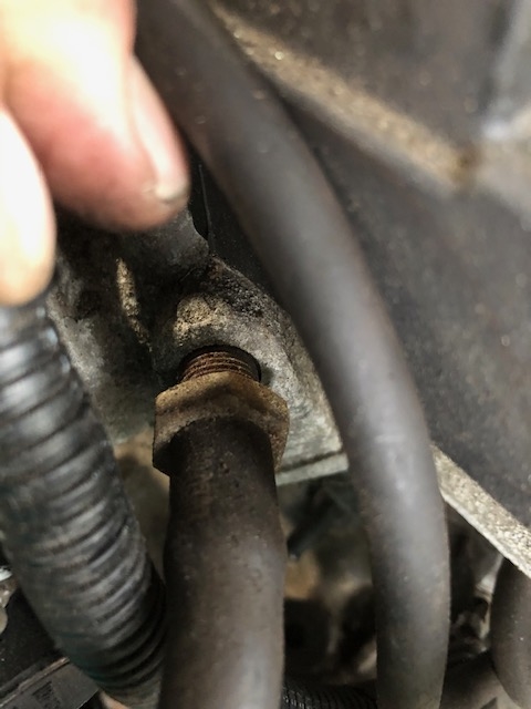

Couple Q’s about EGR and 2000-04 Legacy 2.5

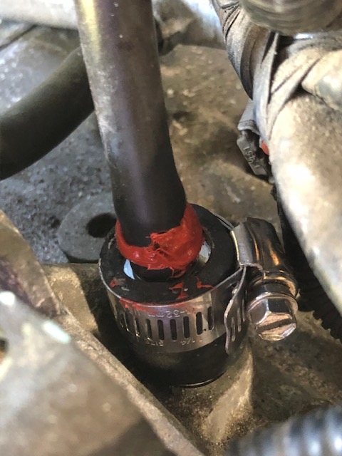

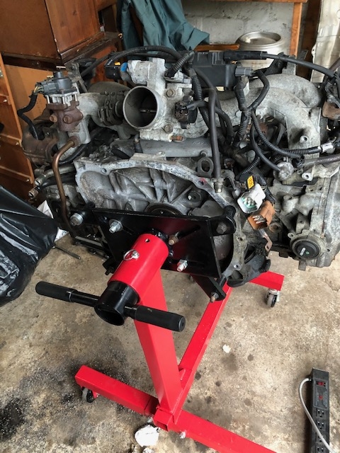

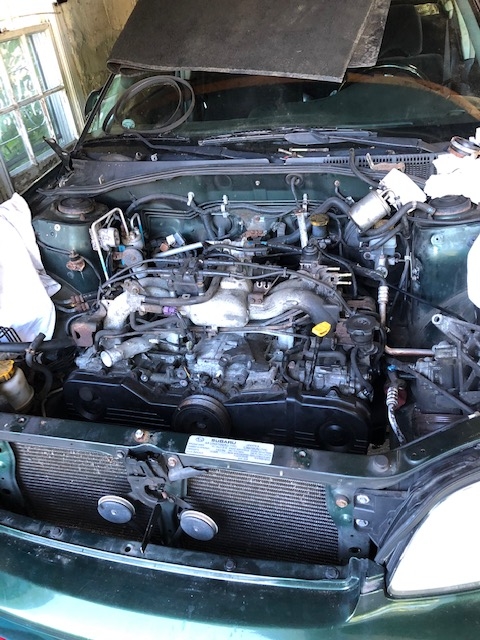

moosens replied to moosens's topic in 1990 to Present Legacy, Impreza, Outback, Forester, Baja, WRX&WrxSTI, SVXOk folks , just to wrap up this episode here we go ... Got this donor engine installed as you can see , Heartless was right and I should have just done the headgaskets when it was out but I plead lack of time and a half dozen other reasons/excuses. So after short time the HG’s were really really weeping and now began the internal issues. Caught it right away but yeah the coolant , the oil , the drama , the suspense, blah blah blah . Sent car to Subafreak for the HG’s and car came back great. Then a couple days go by and I’m getting a code , check engine in then sometimes flashing , fear sets in. After having not much time at all to tinker an opportunity came up yesterday to drive that car back up to Subafreak and in very little time it was discovered that the #3 injector wire was not clicked down. Bingo ! Car is a dream now. I had my nose over that and every other connection and hose and whatnot but do you think I tugged on them ? The answer is now obvious. Reminds me of the glass fuses on the old schoolers. They can look like there’s nothing wrong , but tug on the metal ends and find one has divorced. That’s it kids. Just concluding.
