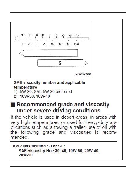

@naru2 If you can't read between the lines, I'm not going to spell it out for you. Both the EA81T and the EJ205 are flat tappet engines, in that sense, they are directly comparable, because modern, off the shelf, commonly available, inexpensive engine oil is no longer suitable for older designs of flat tappet engines. Your average engine oil in 1984 had loads more anti-wear additives in it than oil does today. You can dither on about viscosity all day kiddo, but the oil thickness doesn't mean jack if the pressure of the cam on the tappet is enough to scar those parts due to a lack of molybdenum, ZDDP and other anti-wear additives. The fact that the 1984 and 2002 owner's manuals no longer agree on viscosity/temperature should tell you that things have changed in the 18 years between the two engines... But ya know what, do whatever you 1984 owner's manual tells you to do. I'm sure lubrication technology has been stagnant for the last 35 years, because as they say, "Viscosity is viscosity!" -

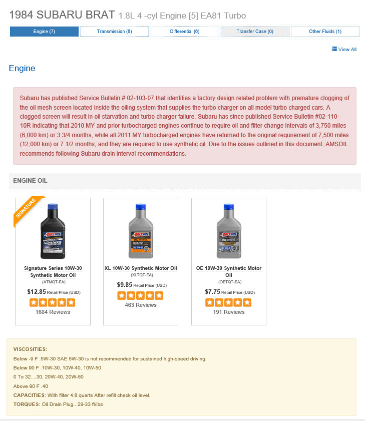

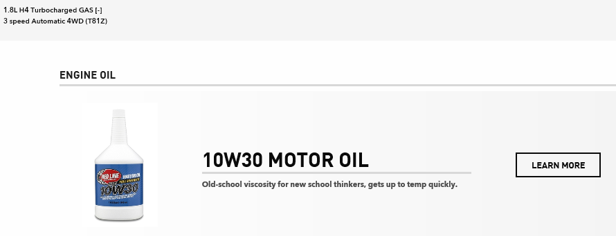

HA! This is coming from a kid who thinks engine oil 100 years ago is the same as oil being used today. You gave me a chuckle, that's for sure! Subaru of America also recommends that you run a 0W-20 oil in their current engine lineup, but in other parts of the world specs a much thicker oil. (PSSST, I have an industry insider secret for you. Not all decisions are made in the best interest of the product. Sometimes, for example, a company will spec a super thin oil to improve their CAFE score, when the folks who designed the engine really intended it to run a thicker oil.) The owner's manual is a CYA by Subaru of America so that they have something to fall back on when some idiot runs 20W-50 engine oil in B.C. year round. They can point to their manual and say, "See, we never said to run that oil in those conditions!" Alright, let's do some oil fun! Just pulled up a 1984 EA81T BRAT on www.Redlinelineoil.com, can you guess what they recommend for your engine?...…. 10W-30. Just to make sure I didn't read that wrong, I pulled up the same info again, this time I asked AMSOIL about the EA81T engine. Holy balls, would you look at that, they also recommend 10W-30! Conspiracy! They do go a bit further, stating that in temps above 90*F, you should run straight 40 weight engine oil. OK, one more place to check, just to make sure there isn't any collusion going on with these boutique oil companies... Motul. Now, their "Oil Selector" tool didn't go back far enough to cover an EA81T engine, so I picked out a 2002 WRX. Guess what they recommend for "Normal" duty? SAE 5W-30. What do you suppose they recommend for "Severe duty" (i.e. Death Valley in the middle of summer)? Right again! 15W-50! For fun, I pulled up the owner's manual for my 2002 WRX. Page 11-13. Option 1 is 5w-30, which Subaru of America says is good from 100*F on down to -20*F. Option 2 is 10w-30 or 10W-40, which SoA says is good from 0*F up well past 100*F. As you can read in the graphic below: "IF THE VEHICLE IS USED IN DESERT AREAS, IN AREAS WITH VERY HIGH TEMPERATURES... USE OIL WITH THE FOLLOWING GRADE AND VISOCISITES: SAE 30, 40, 10W-50, 20w-40, 20w-50." So in effect, 20W-50 IS WAY TOO THICK for anything except towing and driving in Death Valley in the middle of the summer. The only time you should consider using that viscosity when ambient temps are "normal" would be if you're towing in the mountains, and even then, I'd probably recommend a 10W-50 for someone towing in B.C., where the hottest recorded temperature EVER RECORDED was 111*F in Lytton, B.C. on July 16, 1941. Face it @naru2, I blurted out something ACCURATE and subsequently had to defend it, with source material and data (something you failed to provide us). -
