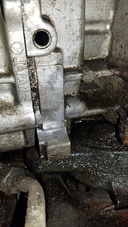

Numbchux replied to Numbchux's topic in 1990 to Present Legacy, Impreza, Outback, Forester, Baja, WRX&WrxSTI, SVXPitch stopper bracket removed, and throttle body to make it easier. And the valve body came right out. This article shows which bolts hold the valve body in. And which solenoid is which. https://gearsmagazine.com/magazine/subaru-cvt-gen-2-valve-body/ Found this video showing how to release the wires from the solenoid. https://www.youtube.com/watch?v=L6FaBvGSTec The cavern where the valve body was: 20210616_212603 by Numbchux, on Flickr The culprit (or, rather, the replacement...) 20210616_210238 by Numbchux, on Flickr I've driven it about 4 times, since. The Pending and confirmed codes cleared and have not come back. I haven't driven it enough to clear the Permanent code, but I have no reason to suspect that won't come. It is interesting watching the function. Once the transmission is warmed up, it locks the converter at about 15 mph, and lets the transmission do it from there on.
