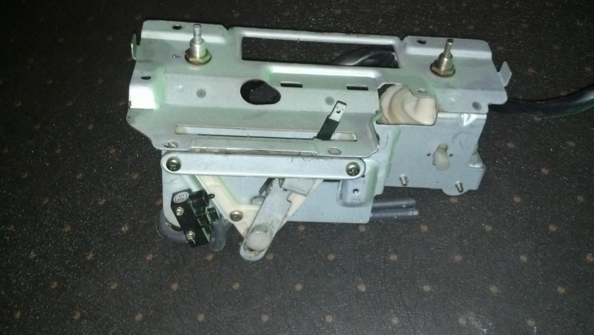

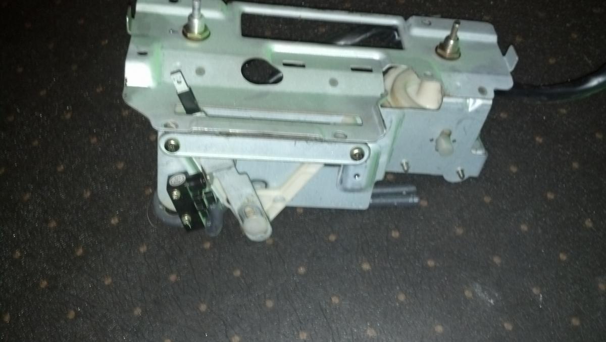

Ok. Here we go again.... It is for max AC recirculation. It changes the door in the heater box from outside to inside air so you can keep cooling the same air in the cabin and not waste 'energy' trying to cool incoming air. It has NOTHING to do with defrost. Look at the pics below. This is an HVAC panel out of a Brat . The vacuum switch is attached to the plate and activated by the mode lever. The first pic is defrost. The lever is nowhere near the switch. Second pic, lever full left, is max AC. The FSM vacuum diagram shows the routing, switch, actuator and door and even labels it inside and outside air. Addition: Gen2 BRAT mode controls are lever actuated, NOT vacuum. It's not a debate, it's a fact. -

We're talking gen 2 here not 1st gen. You have an 'AC ready' Brat. That means that AC could have been added at the dealer if the customer decided the wanted it. I checked my 3 Brats, and my 2 AC Brats have it, the non does not. Also, no push buttons for HVAC on Brats. None the less, look for a vacuum line on the passenger side going through the firewall and if you have it, pull the kick panel. -

Only has the vacuum actuator if it has AC. I've got three, gutted 2 others at the PnP and don't remember having seen the actuator on non-AC Brats. It's for the recirculation door for max AC. You're heater controls would have to be in the max AC position for it to be getting vacuum so either they have failed or the incoming vacuum line could have a hole. Look for any vacuum lines coming through the firewall from the engine. If you see one, then pull the kick panel and check. Easy fix. -
