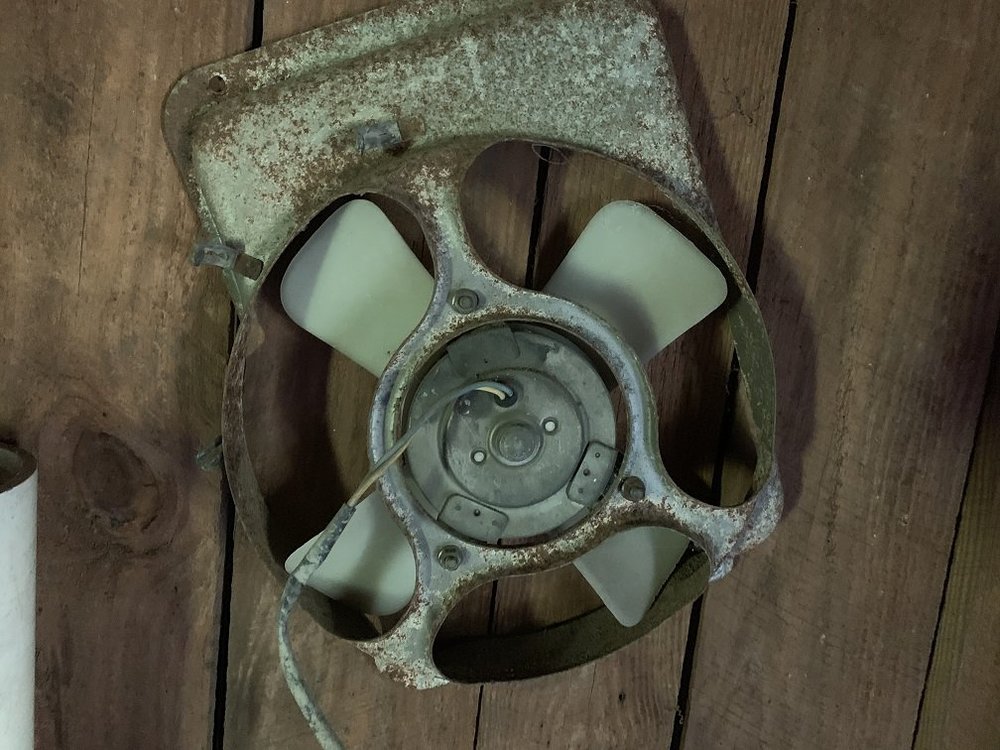

Okay. I work 12 hour shift and start days tomorrow. Would not be able to get it out until Weds. If that is okay with you. I live in the sticks so we only have a small rural post office. Last time I was in there they did not even have a large flat rate box, only medium and small. If they don't have the large do you need the housing if the fan motor and blade would fit in a medium? Your fan the exact same as the one I posted? Just trying to cover the bases, lol! You can private message me you address. I took a few second video of the fan running if you would like it emailed to you? You can private message me your email too if you would like the small video. Figure maybe 5-6 dollars and the shipping.
Good cooling fan replacement
The plug is cut off. I thought this fan was off my Brat. Might not have been. I salvaged some parts off an EA81 station wagon many years ago. If you don't mind splicing your plug on I do have the fan. I will check it with my 12v jump pack to make sure it runs and has no issues. Yes, fan works!
