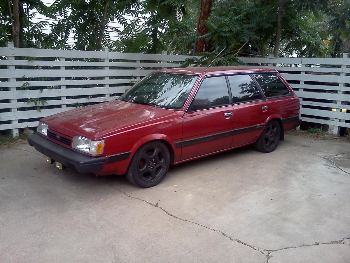

  17. So I have had my loyale five luged for about 3 years, the first two years it was lowered on coil overs and I had no alignment issues at all. Just had to shorten the tie rod ends for proper toe settings. Earlier this year I lifted it up about 2" higher than stock, using forester front struts and had crazy positive camber. I then tried impreza front struts, a little lower, but still can't adjust out the positive camber. Is this common? What have you done to fix this? I'm considering doing the washer mod to the front cross member this weekend but would like to know if there is an easier solution. the pics are to shadowy to see the camber but I thought I'd attach the anyways.
