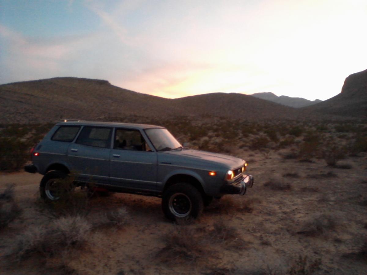

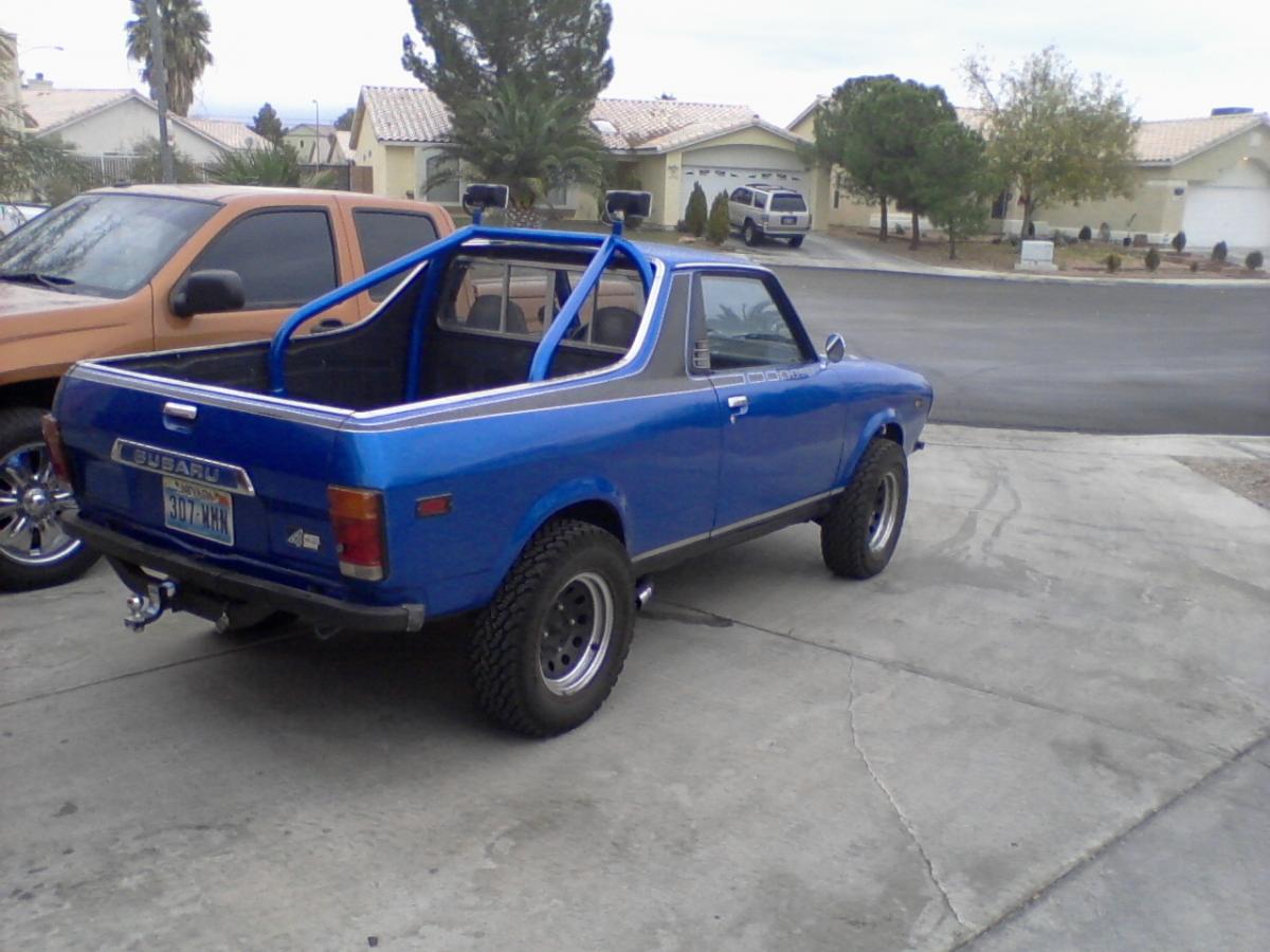

lift is 3in and needs more..tires are 26 general grabbers a/t. brat is sitting for now as my son is going to help me lift it again. it belongs to him now...tires are now on the wagon. -

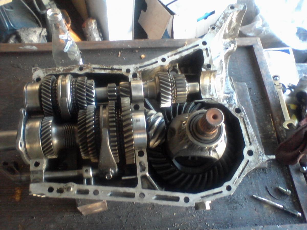

sounds like you have an odd ball ea81single range. I never heard of one until i met this guy on craigslist who had a bunch of subie parts. i bought a tranny thinking it was dual range until i noticed it didnt have the secondary lever going towards the bell housing. i actually used an old dual range that was roached and transfered the single range gear assembly. the gear ratio in the single range is slightly lower. it took some careful bearing sleeve removal but the gear assembly interchanged fine and now i have a lower geared dual range...downfall is im at 400rpm doin 60 with the small tires. upside is car pulls my 26''tires with ease. i just popped off the spedo needle and set it at 10mph bottom out so it reads somewhat accurate like a mountain goat on trails but struggles a little on steep highway hills. -
