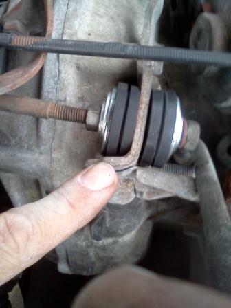

  25. could this also be called the "engine stabilizer bushing" or "torque strut bushing"? I found a part # "A6726" but is kinda looks like a control arm bushing.
