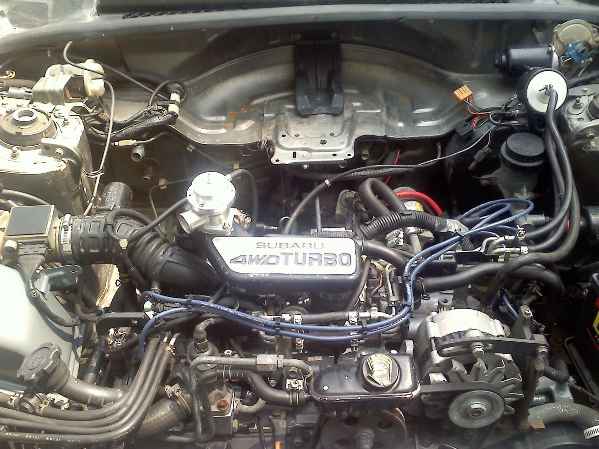

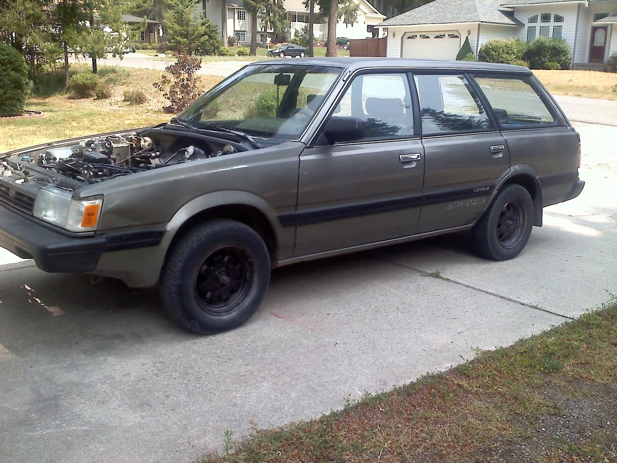

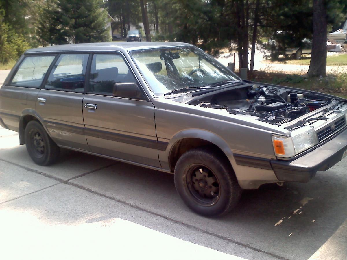

  12. Hey everyone, I've been on the board here for a while but I've never been able to get any good pics of my Rallywagons, so here's my Rallywagon II 01/89 Loyale GL Turbo - brand new CCR EA82T, bored .30 over, ported stock VF48 turbo, stage 2 Delta turbo cams (260*), Blow-off Valve, and a Dual range 5spd 3.90 transmission And an amazingly clean engine that makes me stare at it all the time haha I'll post more pics of the engine soon(: Thanks for all the help on the board everyone!! I'll be here for a long time(:
  13. My CCR EA82T with ported out stock turbo and stage 2 cams makes plenty of power up til 6.5-7k rpm... oh yeah, and 10psi boost with higher than premium gas(: the 2.5" straight pipe makes it sound like a performance V8 after 5k rpm lol
