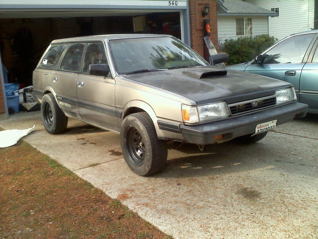

ive already been tearin this engine up, i shift at 5 or 6k every gear HAHAHA havent had any issues yet. MPFI block, vf11 turbo, 3rd gen heads w/stage 2 delta turbo cams (14k miles), and slight porting n polishing. seems to do fine @10psi with the stock ECU you probably boosted it too high.. im running 10psi and it doesnt lean out at all, all the way up to 7500rpm. lots and lots of bottom end torque and still pushes top end power pretty good thanks Jono, im going to adjust slightly until i like how it runs (: i rebuilt everything in this engine.. smoothest running EA82T ive heard yet haha -
its up a little in one pic to like 10psi ive never had one mess up, either did or didnt work haha
