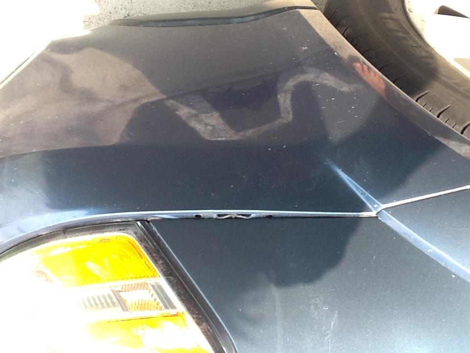

  21. Some ungracious person in a public parking lot let us an anonomyous love tap. None to serious if I can just figure out how to get to it. From what I can see craining my neck around under the car and the hood, it's a simple case of TAB A into SLOT B, assuming that there is a tap on the fender merge. If so easy enough to slip in, and from what I can see in the fender it's a light gage metal strap behind the plastic fasia, shoul be able to muscle it back into shape ... problem is, how to get in there. Any ideas? ps: I have no idea why my pic posted upsidedown, maybe someone in Australia can help me.
