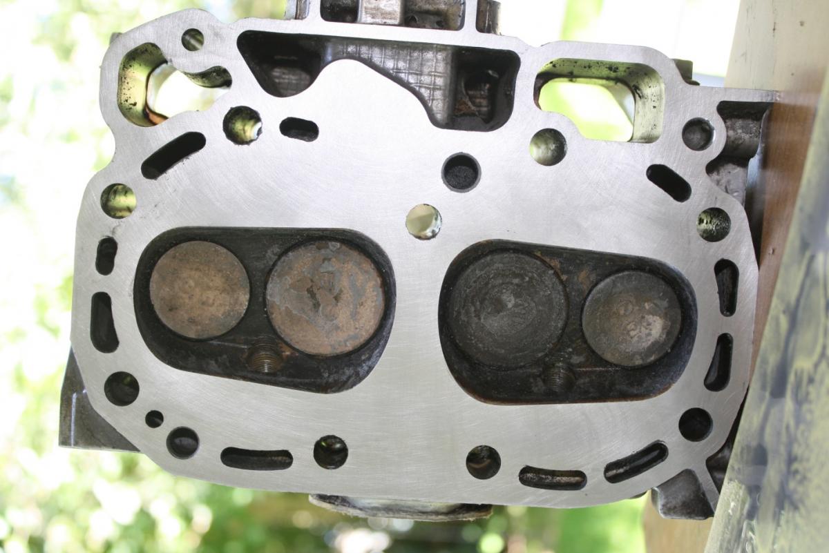

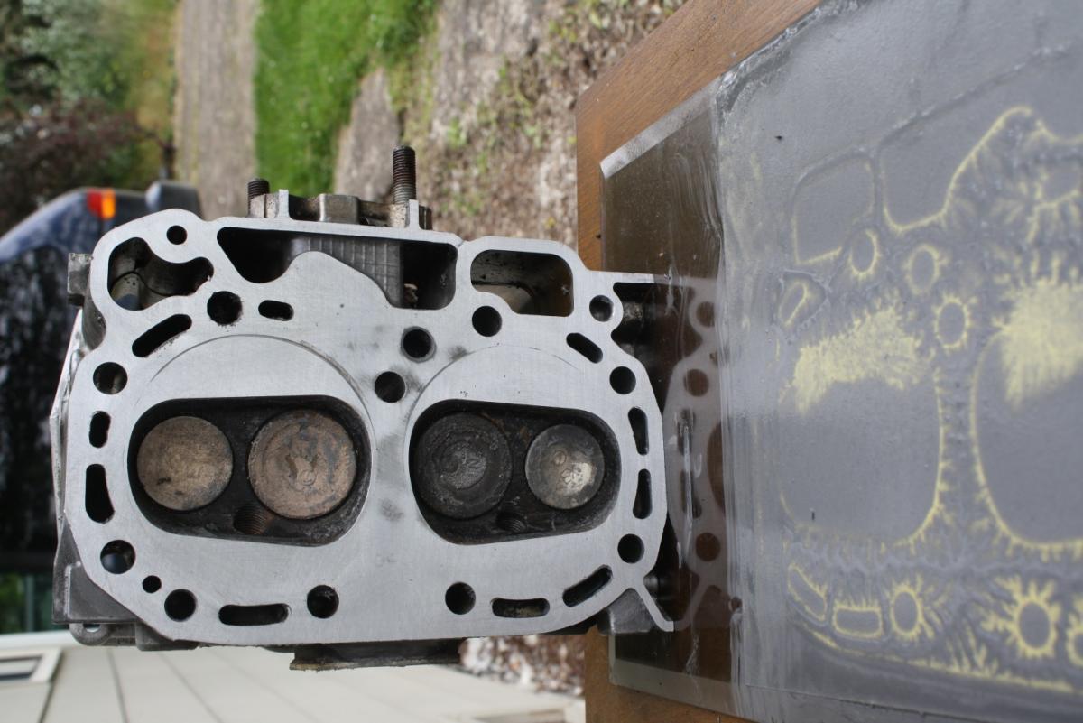

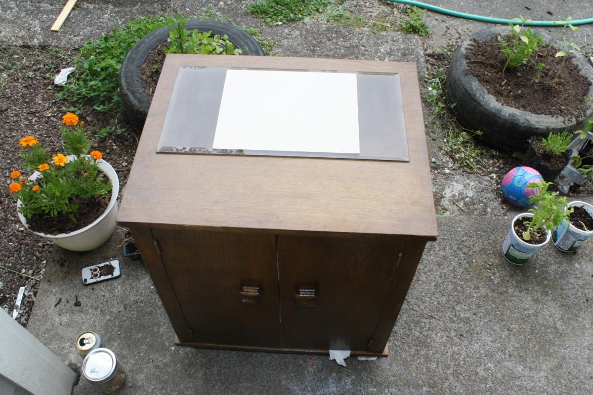

June 3, 201411 yr Hey there thanks for an awesome post. I am doing my headgaskets for the first time on my ea82 and used this approach. Here is my set up. I used a spray on cement to help keep the adhesive evenly distributed. This is where I started Somewhere in the middle FInal product after swapping to 320 finish I measured it with feeler gauges and it is now within spec. Any tips how to deal with the block or should it be left alone after removing gasket material? Some of that material is on there pretty good...
