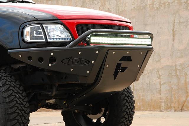

These have been some awesome pics and building threads guys! has anyone ever built one that looks like/or is similar to this:
Keep the ideas and building specs coming guys!

I was thinking of doing a very simple black bar that would only wrap around the front of the bumper and nothing else to it. Add a few lights in the center.
Something like this would look good on my loyale.
