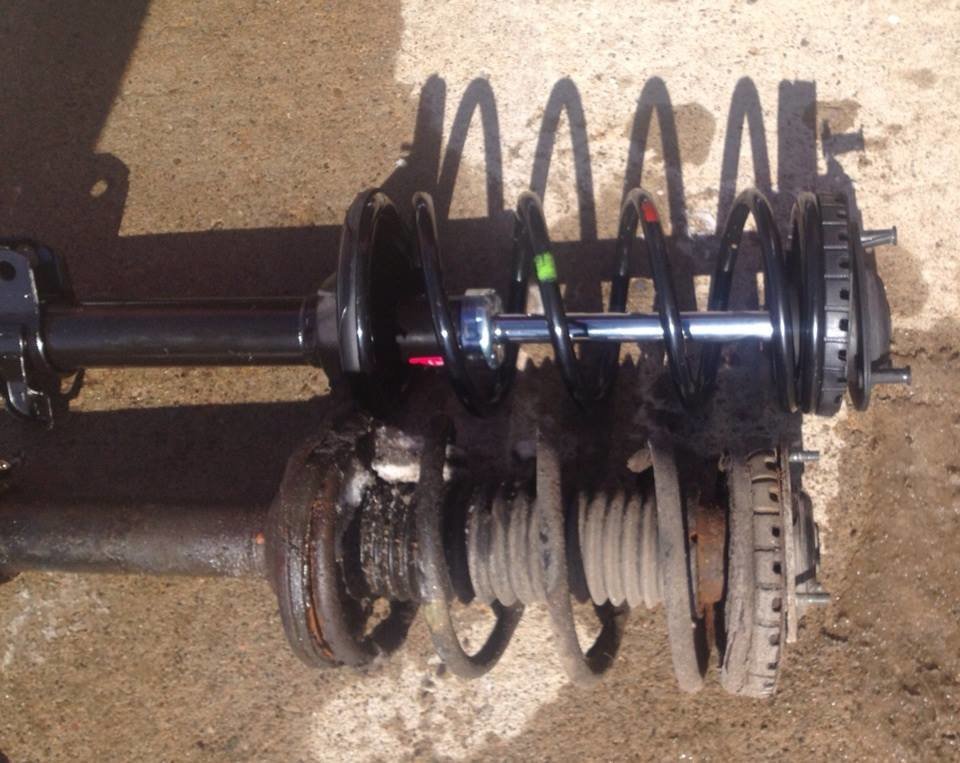

this is what the assemblies look like off the car.
obviously one is new, the other old - top is to the right - but the nut you are trying to get at holds the spring under tension under that top plate.
you need to compress the spring before removing that nut.
