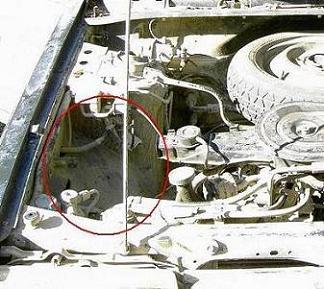

I too have had water up over the hood, but went to fast, and the stock "cold air intake" sucked muddy water up into the carb, so I took it off, if you've got a carbed EA82 you could do the same, but I'm not sure what to do with the airbox on an FI model
I attached a snap of my "modified" intake
