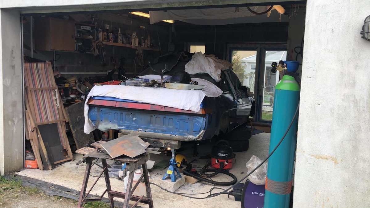

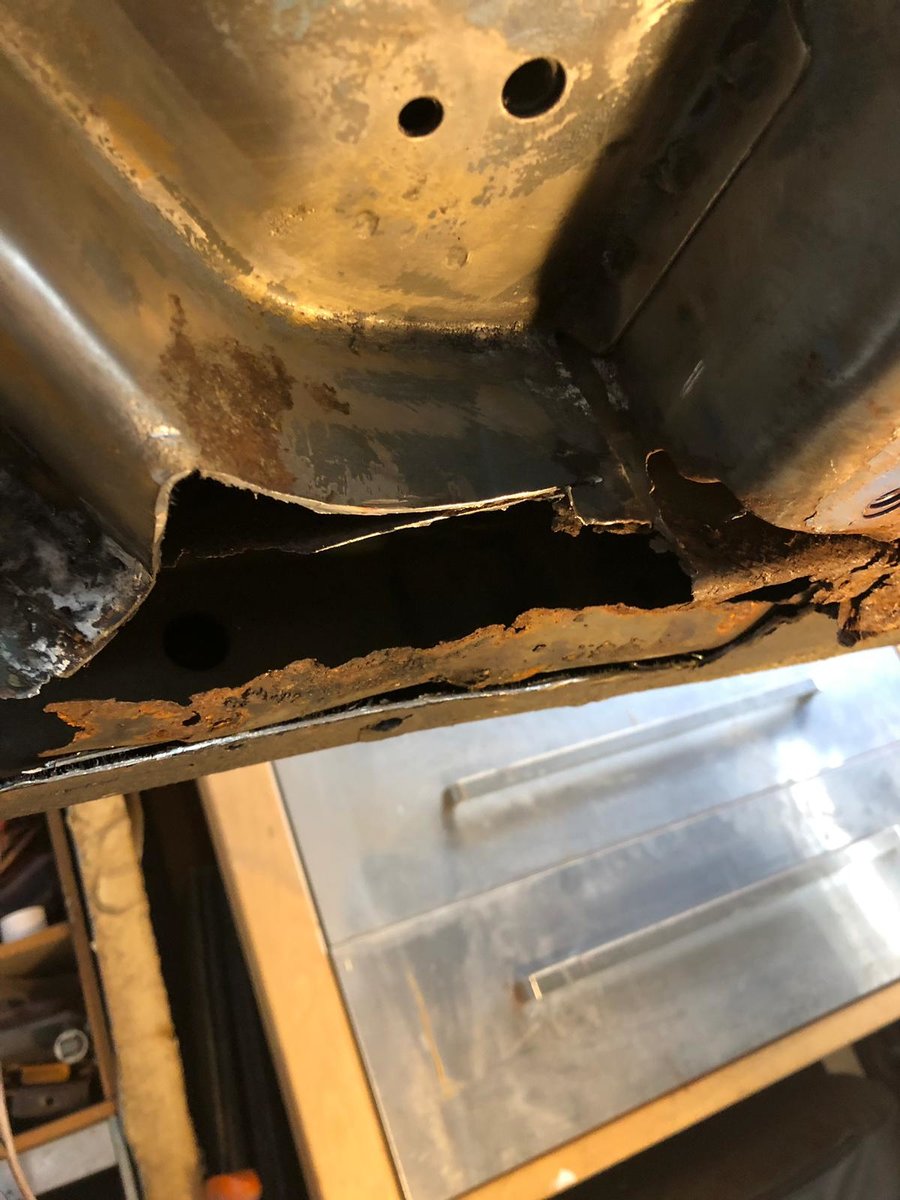

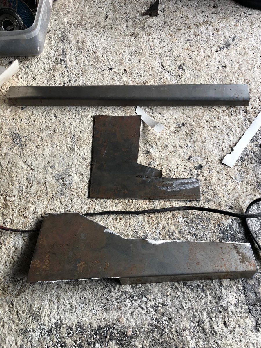

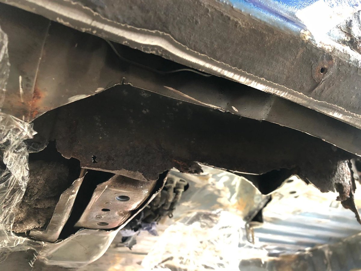

  5. Morning guys. lovely day here on the coast of Wales. today, I need to add metal to my rusty sills ( rockers) and rebuild rear suspension attachments. my welding skills are improving i hope not to burn myself to much today #upsidedownwelding i have to weld these pieces in ( see pics) ive cut out all rust, removed surface rust with acid. Today I will start to tack the metal in place and fabricate other pieces. its quite a lot of work to shape and bend the metal. Plus not losing any lines or dimensions. ive already done the other side. so this is less daunting. After ive repaired this section the rear underside is fully repaired. Behind the cabin floor pan. i will epoxy prime, base coat in correct 572 space metallic blue and 2k clear. (my car was originally painted 518, blue and white, i’ll respray whole car original colour in future.) i can think about reattaching the rear refurbished suspension and brakes to the car. i still have the rear wheel arches to do too...
