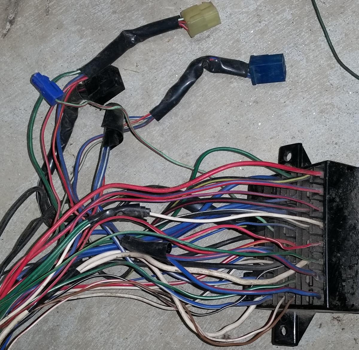

Update so far. EGR seat looked good. Moved normally. I'll have to try that method of watching the injector. Tonight, I powered the fuel pump with cord I made from a spare wiring harness. Fired the injector via an engine harness and test leads. Didn't go crazy continuous, as I didn't want to fill up the intake with gas.... Talk about flooding. Seemed to spray and stop nice. With the boot off and MAF unhooked, it will just re start? I'm assuming I should do this with it warmed up.
