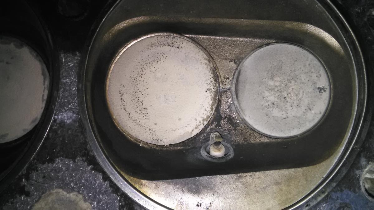

  19. This attached pic highlighted spot appears to show the valve seat cracked as well. I will still disassemble it and check further . This 1991 loyale ea82 spfi engine was cruising at 55 mph and started shooting out steam coolant and oil . no water in the oil pan . immediately shut down. no overheat . I suspect the head is cracked to the coolant passage .
  20. I don't suppose these are permissible hairline cracks .
