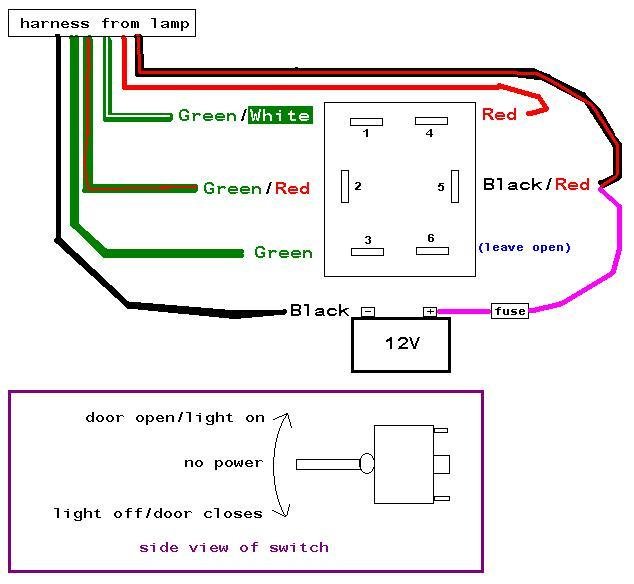

need help/how do you wire the third eye passing lamp for brat
I noticed that after sharing this post (dummy head) these files are no longer available so here they are again TOONGA centerlamp-relay.pdf Passing Lamp Discussions and Wiring Notes.pdf
