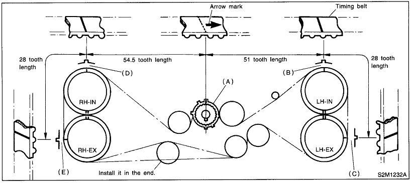

  4. Okay, this is a customer's car that I've been trying to diagnose for a few days now. quad cam 2.5, 1996 legacy. Assuming it's an ej25D (Pardon me I'm more of an old school EA guy) Anyway, I've checked compression on both pass cyls and the front driver's side cyl. All checkout (+120 PSI) I have spark on those 3 cyls as well. I've checked the timing using the attached diagram, all that checks out. Now the alignment marks that point to eachother on the intake and exhaust cams are off a little bit, but I've read that that's normal and the tooth count is correct. So I'm stumped . It will occasionally fire on what sounds like 2 cylinders, and while cranking when I let off the starter it will also occasionally backfire out the intake. I'm under the impression that even if that last cylinder had zero compression and/or fuel/spark, it should still fire up and run on 3. I can't get it to run but for maybe half a second, and very seldom. Looking for some direction here, thanks in advance.
