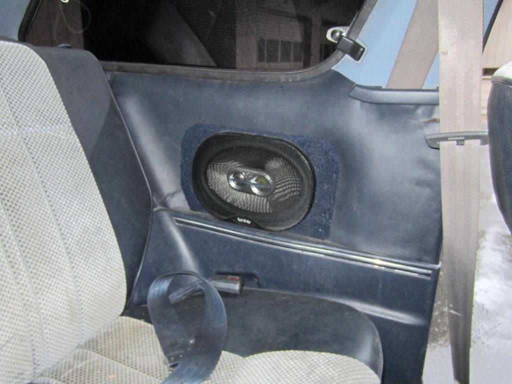

IMO all the rear cubbies do is get filled with sticky garbage... but they are the perfect spot for 6x9s. -

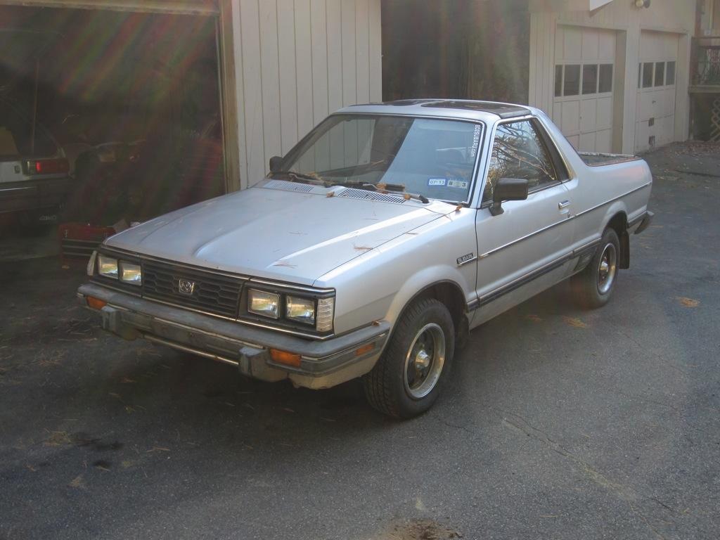

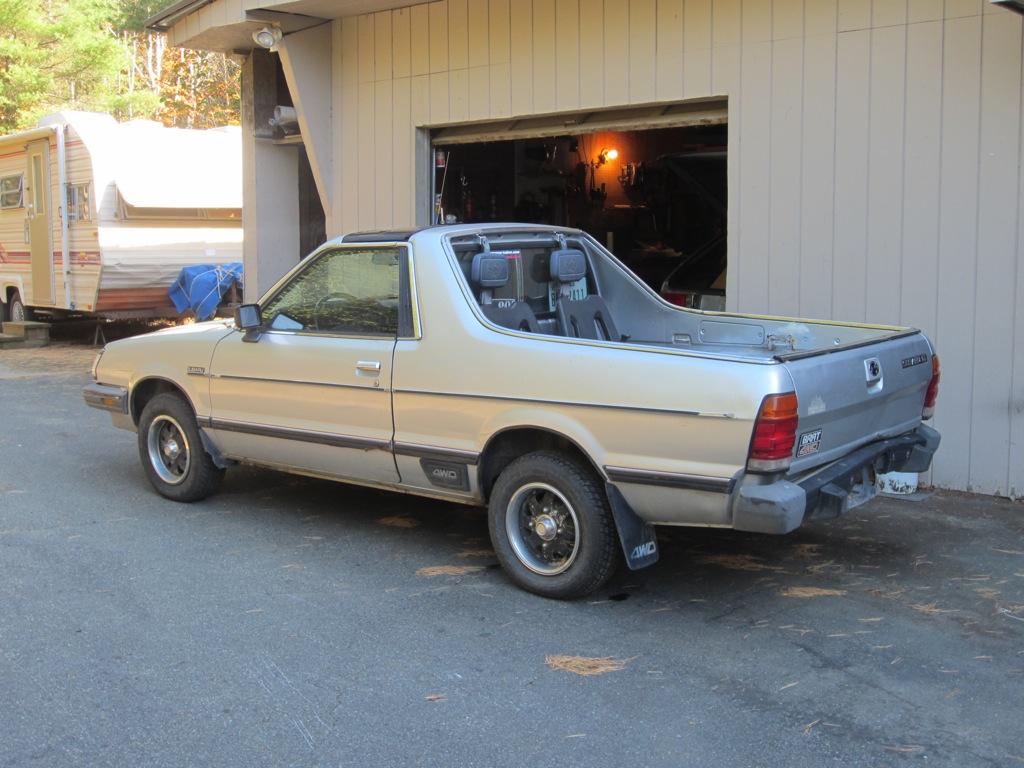

Thought I'd show off my new brat and get some help spitballing for ideas when I start to build it up! It's an 84 originally from Texas. A bit of rust but really nothing compared to what I fixed on my 88 hatchback (build thread). It was a surprise present from my incredibly awesome girlfriend. Kinda cool that's it's the same color as my hatch. They will be a matched pair. Anyway, I'm thinking EJ 22/25 Frankenmotor with porting and torque cams, 5spd D/R (I have one EA-EJ adapter plate left!), 6 lugs with BFG All-terrains, 3 or 4 inch lift, rear discs... I also have a power steering rack and cross-member but I don't know if I want it for my hatch or the brat... what else... make the jump seats removable, nice thick bed-liner, new paint, maybe some custom plate bumpers with hidden winches... kinda dreaming here but it's fun to do!
Very cool! Looking forward to seeing the final product.

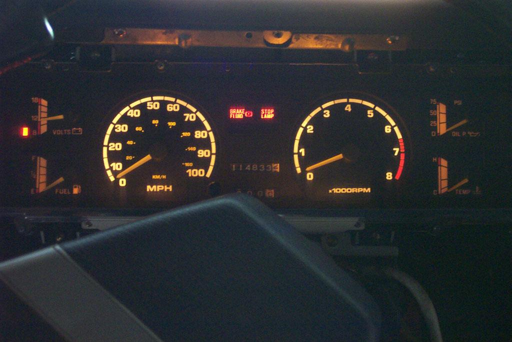

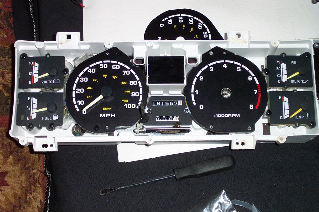

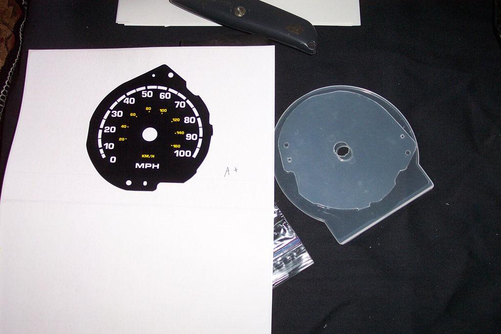

Thought I would do a couple posts on some of the detail mods I did. First was correcting the speedometer. I scanned the stock speedo face and rebuilt it adjusting for the larger tire size I would be running. I work as a graphic designer, so recreating the speedo face on the computer was easy to do. I printed it on heavy stock and then affixed it with double-sided tape to a piece of plastic I cut to size. While I was at it I upped the redline on the tach for the EJ22 I was dropping in. This was an early test with the lights on. I think I reprinted them to match the stock orange color a little better soon after. Overall, this was one of my favorite mods on the build.

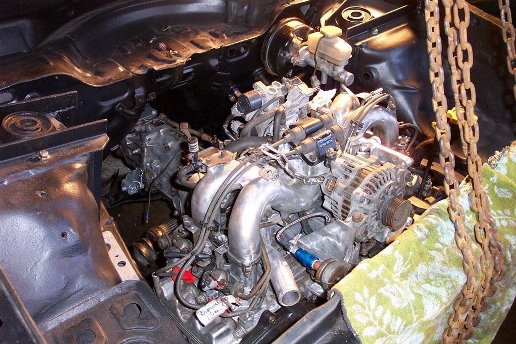

That engine bay is gorgeous!
No prob! Hopefully providing some inspiration for others with their builds. I know seeing a good build thread gets me pumped for my own projects and gets me coming up with all kinds of ideas. Still got a few more to share, too.

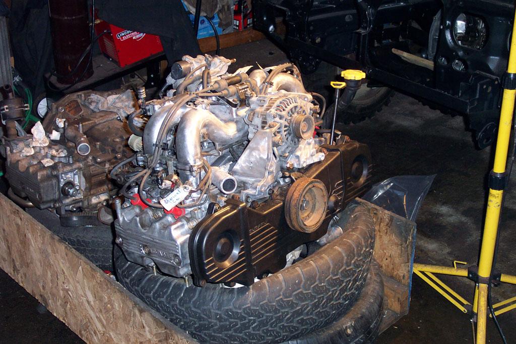

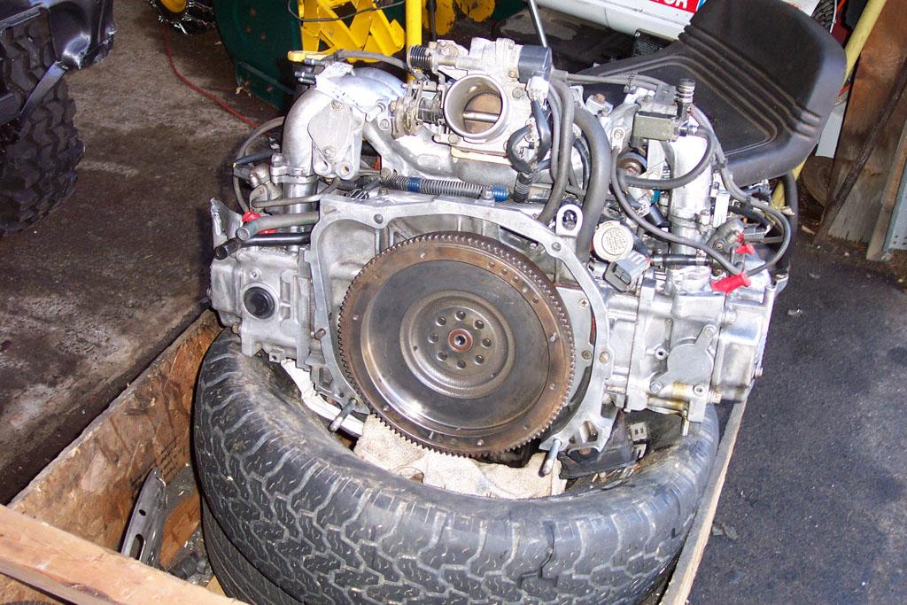

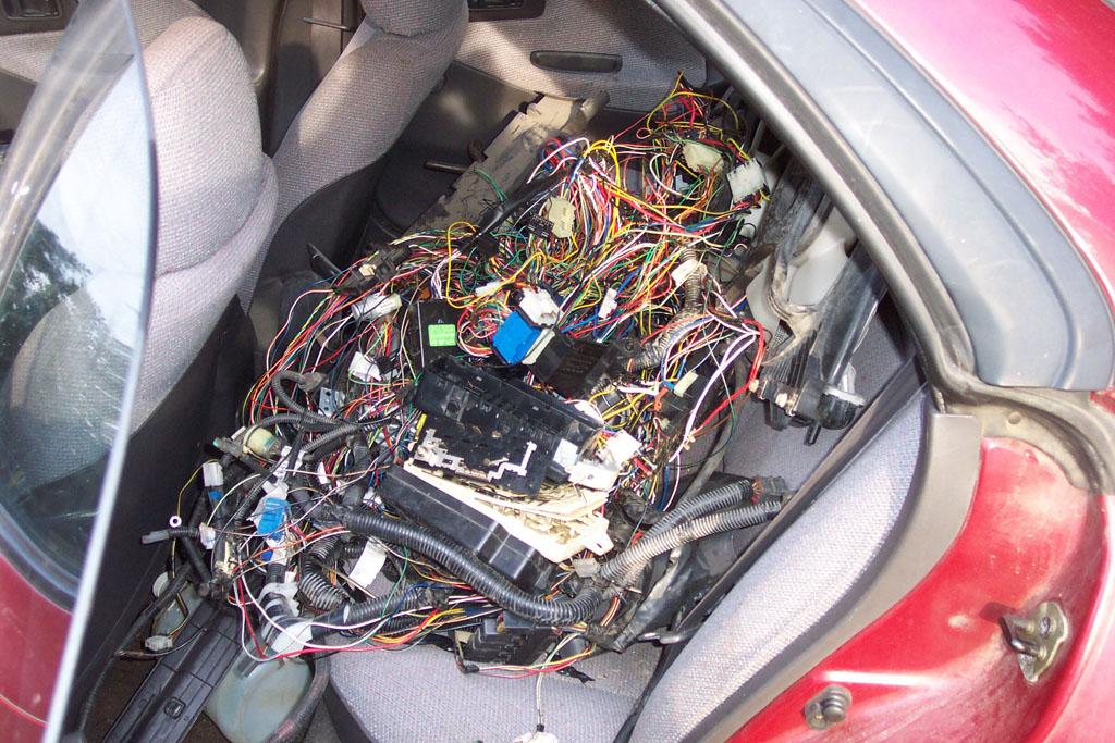

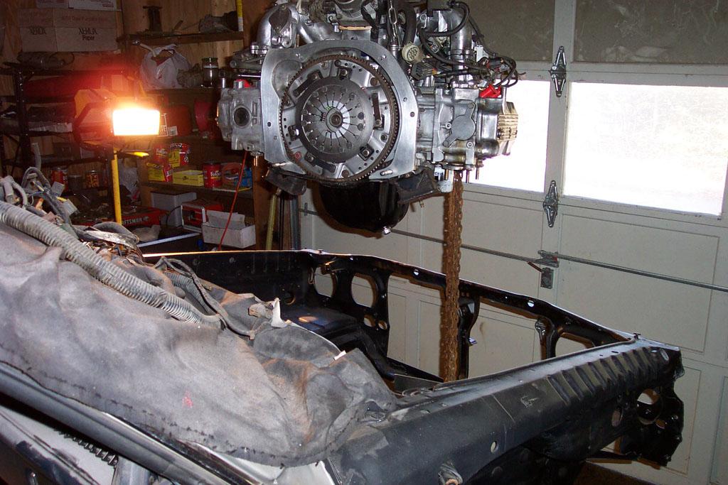

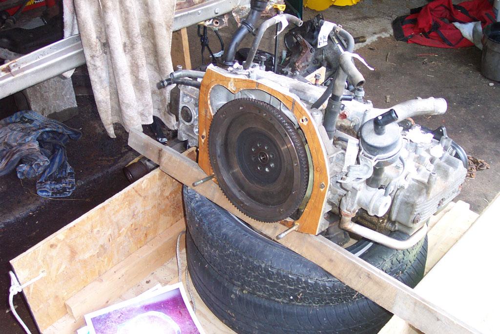

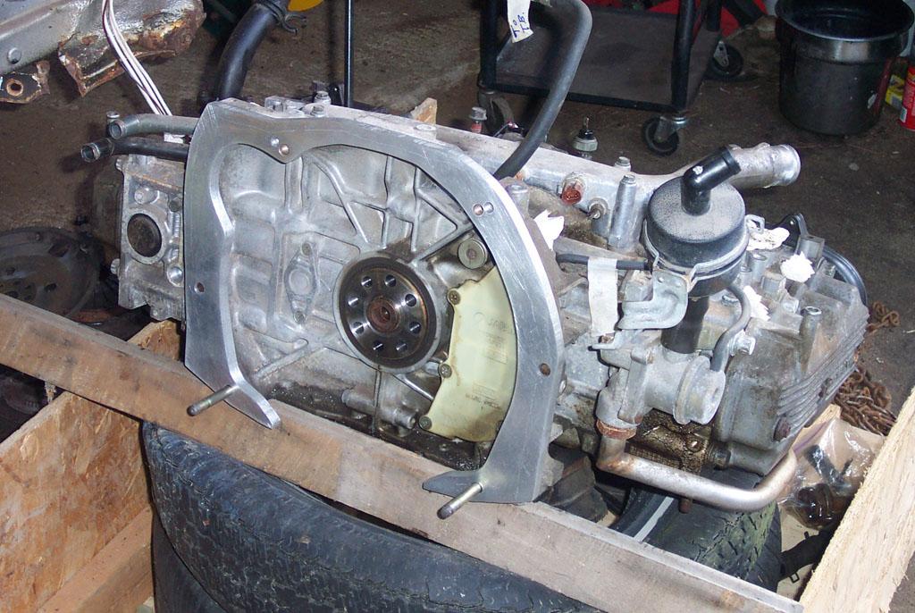

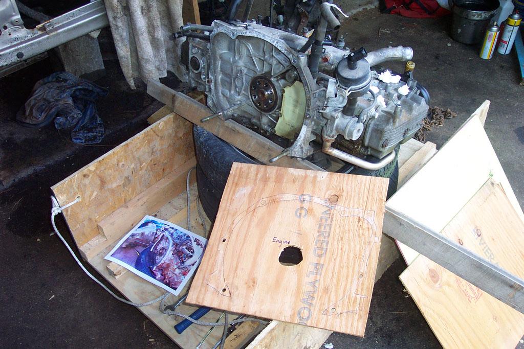

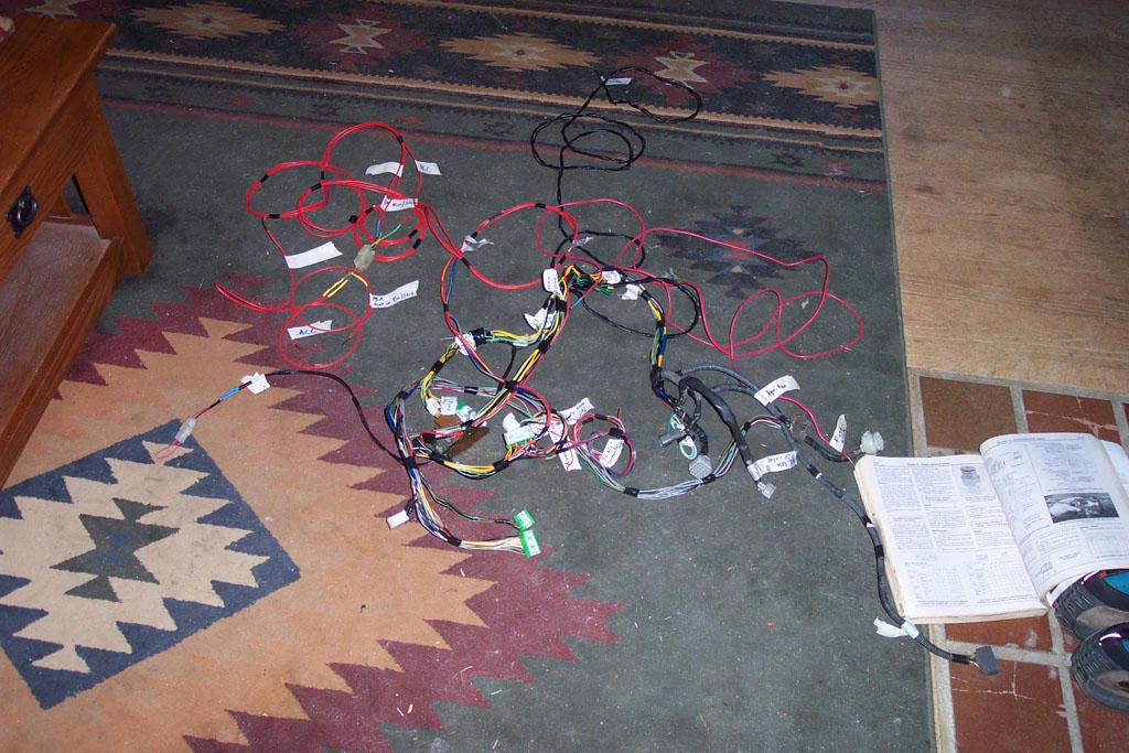

Here's a few from the engine swap. Making my first EA-EJ adapter plate: My prototype was 1/2" aluminum, hand cut with a jigsaw. The plates I later put into production were CNC cut steel. Flywheel was welded up and redrilled. EJ22 cleaned up a bit. Stripped harness: All the wiring I stripped off the harness:
Thanks! Looking back it was a crazy amount of work... I couldn't image doing it again. But I'm really glad I did. And I hope I can do it again, cause I just got an 84 Brat that needs almost as much love!
