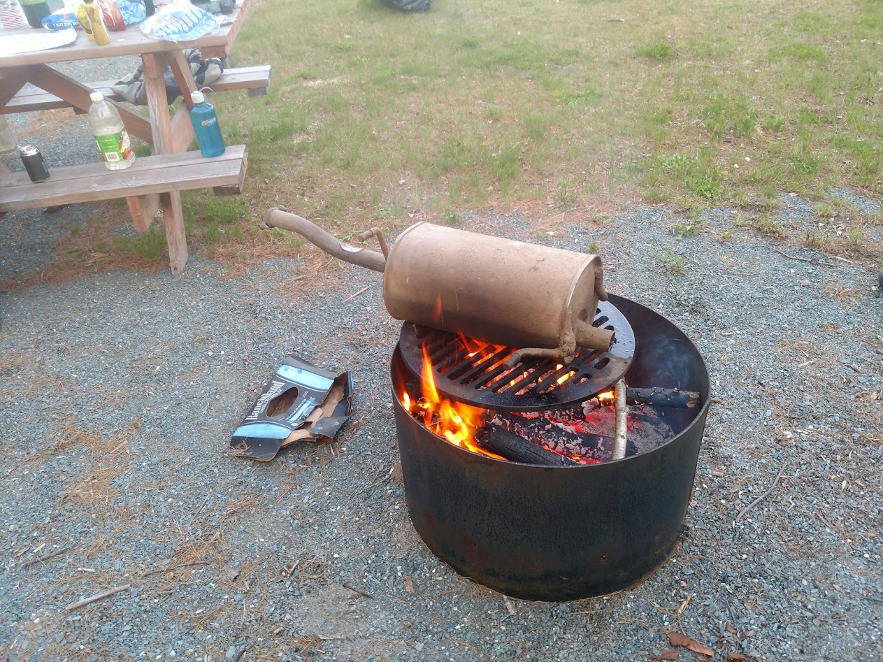

We removed the rear muffler from the Impreza and since it had a fair amount of water in it we put it over the campfire after we finished cooking.

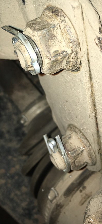

Monday morning we checked over the cars. Both front control arm nuts on the black Outback had backed off a lot, the one almost to the end of the stud. We headed to the pond where C swamped his Impreza, had about as much water in it as it did then.

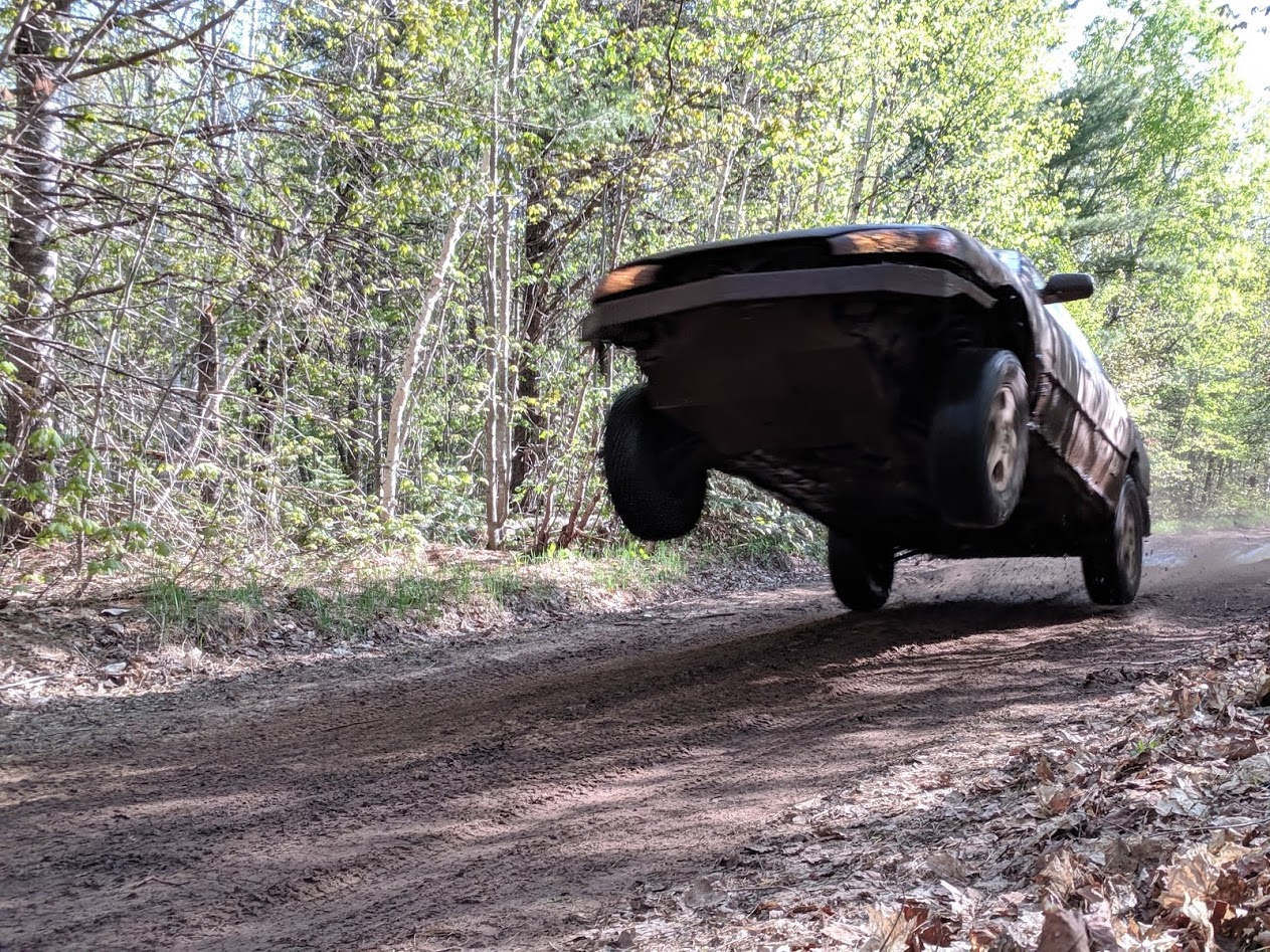

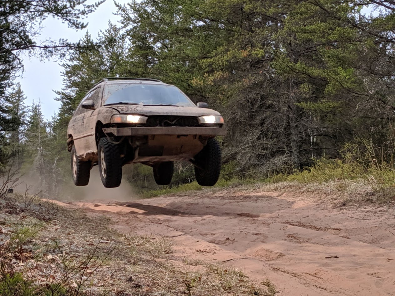

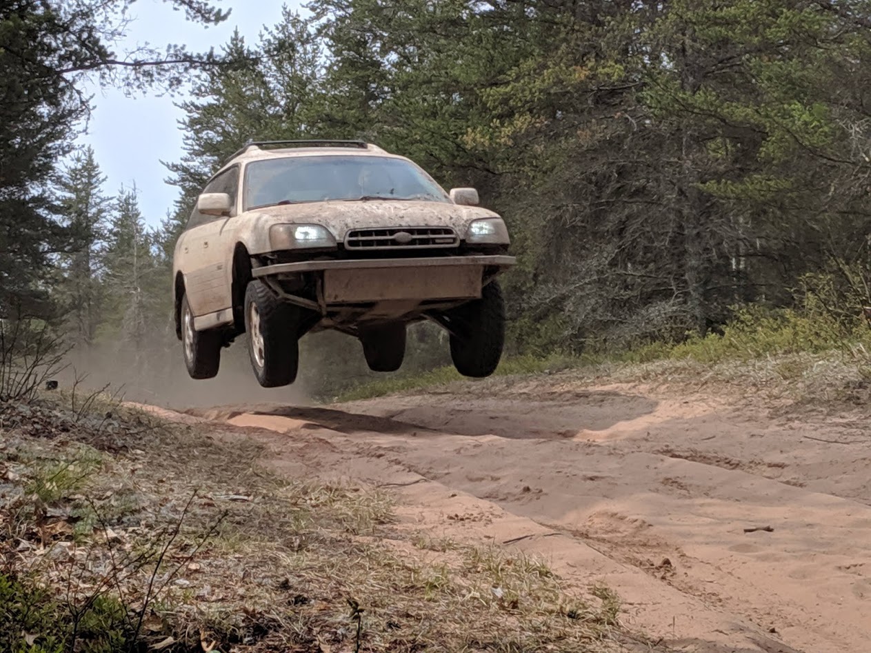

We went back and hit the best dips/jumps on the road just before the pond where B blew out the strut tower on his green Forester. The last big one made the black Outback wheelie a couple times.
The other runs it just jumped level, not sure what made the difference. While taking runs at these dips/jumps I noticed the clutch was starting to slip. Figured we'd just take major snowmobile trails down to the big spring. Wound up taking a ~15 mile dead end to a couple big water holes. The first one was about a quarter mile long, couldn't even see the end of it. Took a different route and that one went to a water hole that was shorter but probably quite deep so we turned around and drove all the way back to the highway.

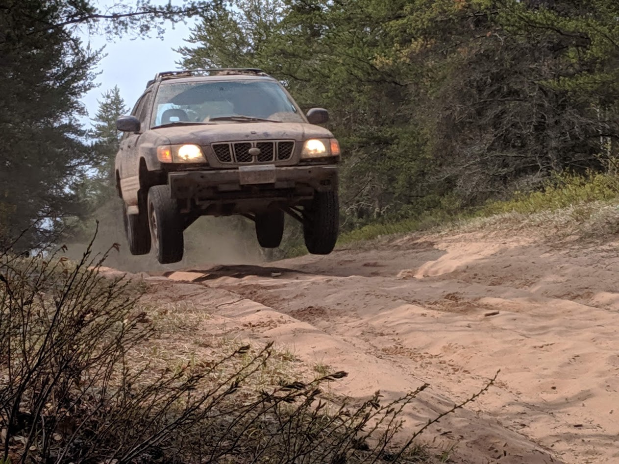

Much of that snowmobile trail has little jumps/whoops that sneak up on you, just cruising along at 50mph and all of a sudden you hit a dip and you're in the air. At this point we didn't have time for the big spring and the super whoops. The big spring was farther out of the way and most of the group preferred seeing the super whoops so we headed there, had to drive on pavement for a couple hours. Clutch in the black Outback was definitely starting to slip over about half throttle. Sometimes with the cruise on going up a grade you could see it slip 50-100RPM and then come back down. We hit some little whooped out sandy trails on the way there. Along the paved road to the super whoop parking lot was a narrow sandy trail with small whoops so we hit a portion of that. The guys pointed out it would make for great video driving along the car filming from the side watching the suspension thrashing up and down. At this point I'd noticed a pinhole leak in one of the fuel hoses in the black Outback so I fixed that. They took everything out of the back seat of the white Outback and took that and the Forester through the super whoops. Apparently the rear end of the white Outback kicked up badly with four people in it. They came back just as I was finishing washing the fuel off my hands and arms and M and A and I took the white and black Outbacks up the first half of the super whoops, switched cars, and came back down. The black Outback was definitely better but the white Outback didn't kick up too bad with just one person in it. On the way out we drove part of the mini whoops with the black Outback and Forester and filmed with the other two cars.  We dropped off J on the way home and all the cars drove home OK.

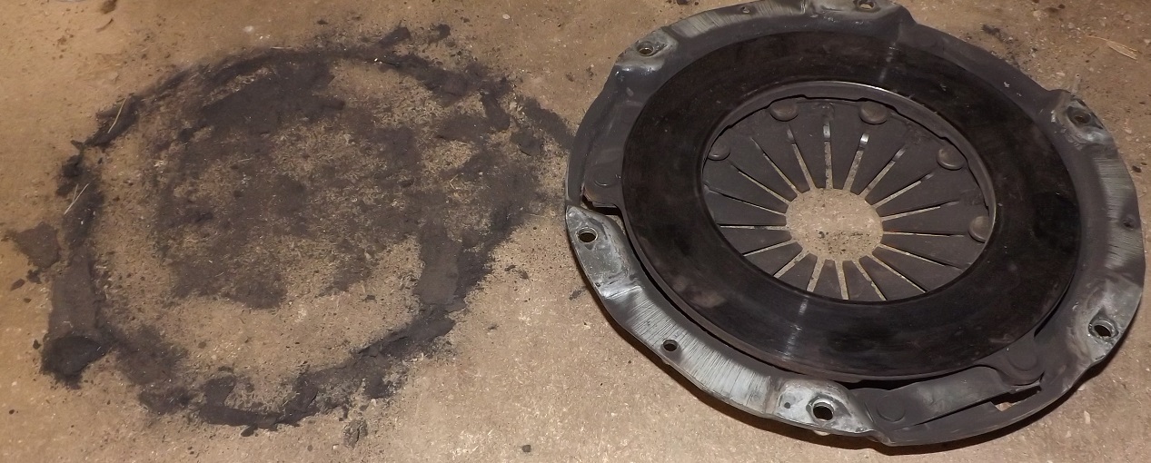

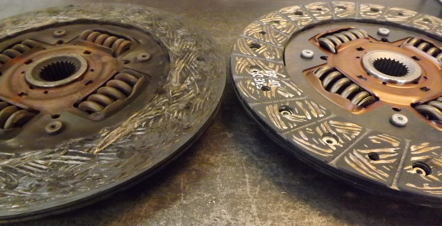

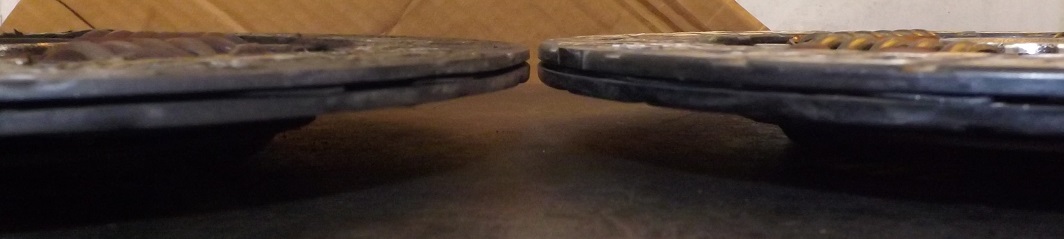

Clutch in black Outback still slips some, seems to be fine when you first drive it and then will slip after maybe five minutes of driving. Thinking that might indicate an oil leak so I ordered a rear main seal and rear cover o-ring for the engine and input shaft seal for the trans. Windshield isn't any more cracked than when we started the trip, still just has the cracks down in the passenger side lower corner. Never had to bend the wiper arms/cowl either. Needs a driver's side front CV axle, it was making a little noise at the start of the trip and a little more by the end, the outer boot is badly torn. B and I both drove it with the parking brake on so that needs to be adjusted.

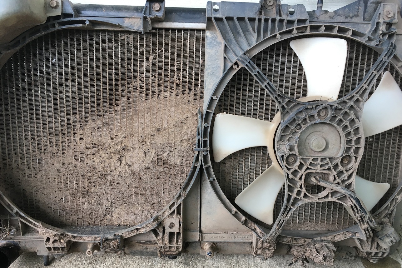

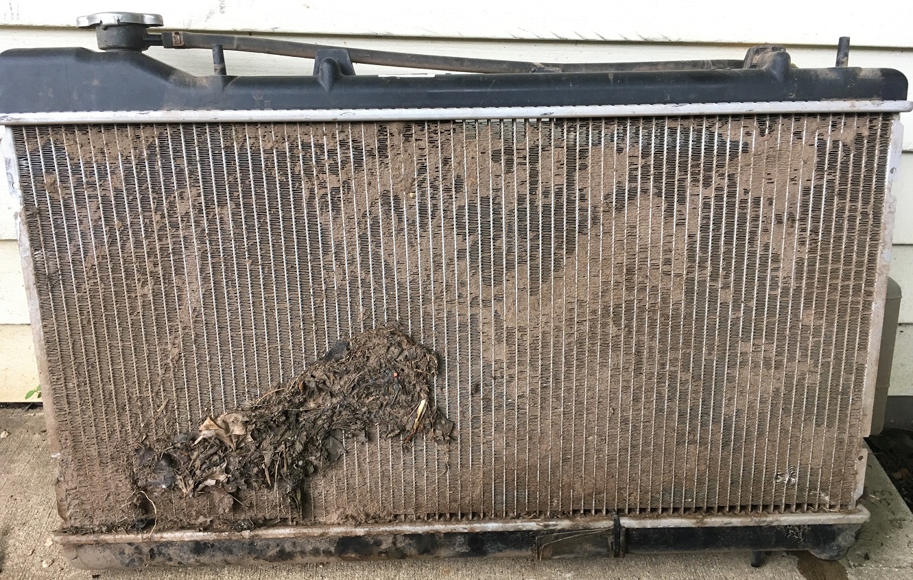

Impreza radiator was quite muddy front and back even after blasting it some at the coin op car wash.  Had just put in a new one too, this is basically all from the UP trip.  Outback radiators seem to stay pretty clean with the guards on them but I should take a closer look to be sure.
Came clean pretty quickly with the garden hose.

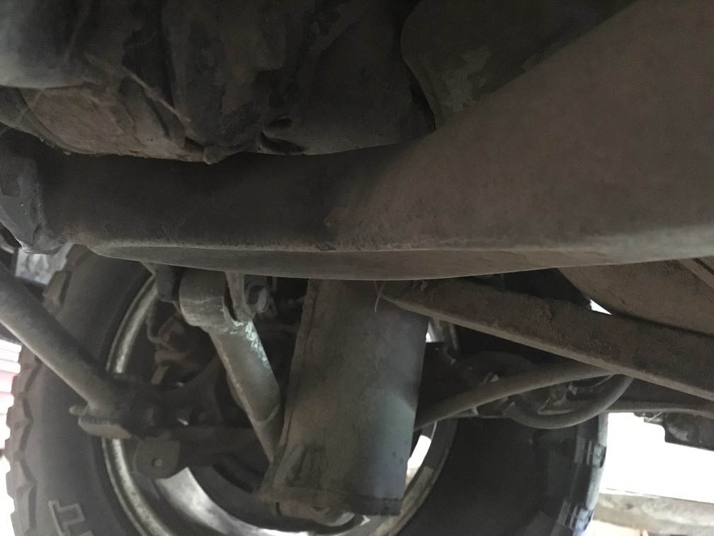

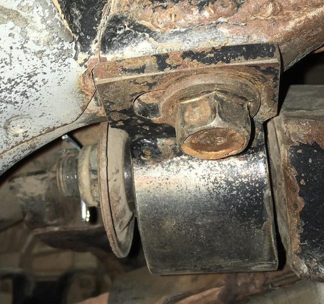

Rear bushings in the fabricated brackets I made for the black Outback's front control arms kept walking out during the UP trip.  Took the arms off, bushings originally pressed in but now just slide out.  Pushed them back in and tack welded them in.  We drilled those studs and the front strut eccentric bolts for cotter pins.  We replaced the clutch disc and LF CV axle. New clutch disc measures .34”, old one measured .23” and was worn down to the rivets. Pressure plate had a bunch of dust and fibers in it, cleaned that out. Pressure plate measures about .21” relaxed (fully clamped) so there wasn't much pressure on the clutch disc. Should probably replace pressure plate but figure the 6MT will go in over the winter.

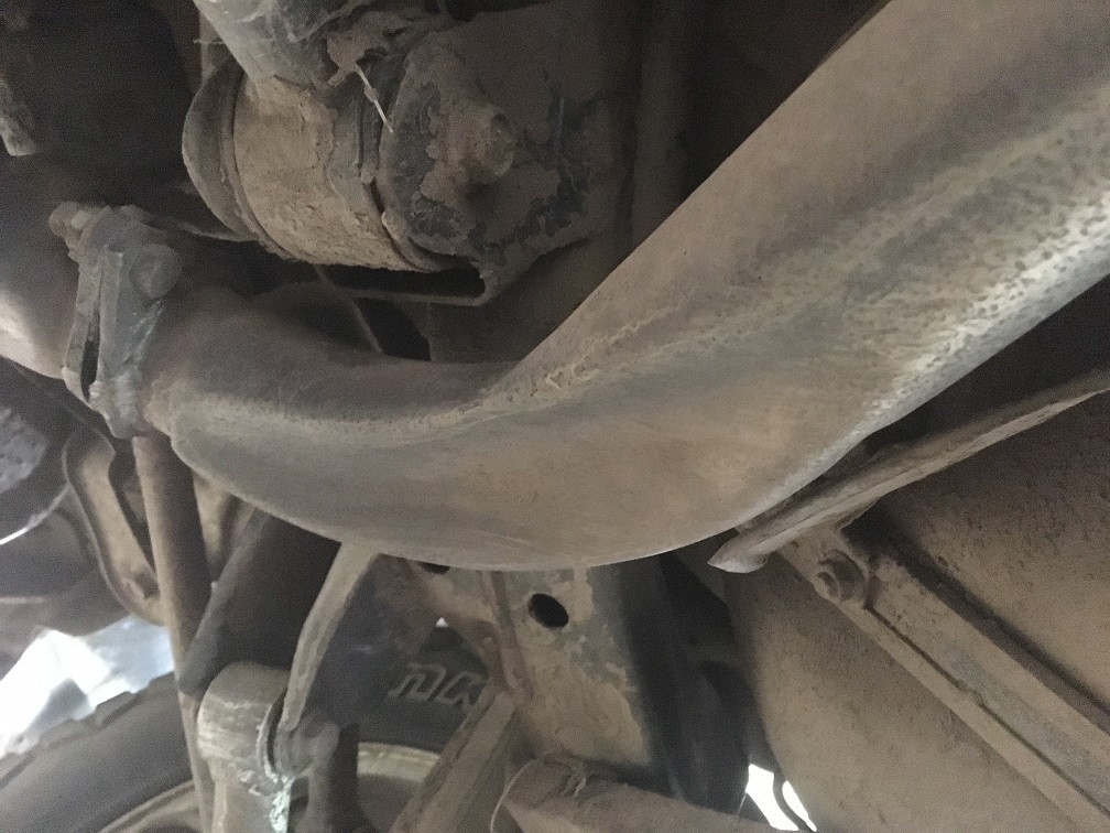

Exhaust on the white Outback is badly dented where it goes under the rear subframe, probably down to about half the stock cross section. It was rubbing on the driveshaft again so I bent it down as much as I could, has a little clearance now.

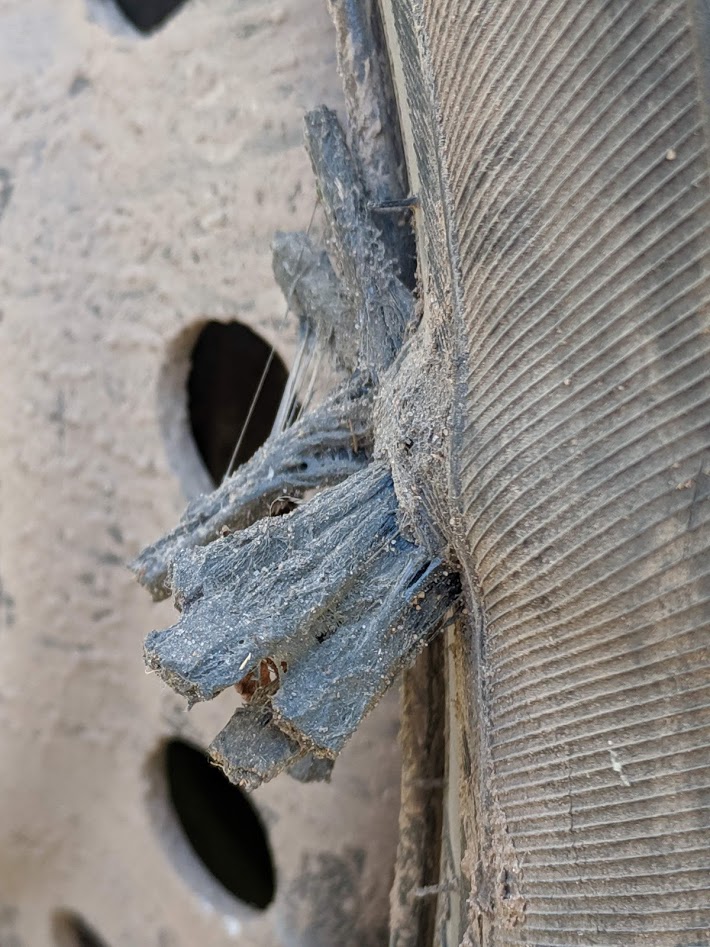

Fixed some tire leaks.
Pictures of the cotter pins on the front suspension of the black Outback.
Radiator on the black Outback was also muddy, not as bad as Impreza but we're going to a desert race so I want the best cooling possible.  Removed the radiator and blasted it out with a garden hose.

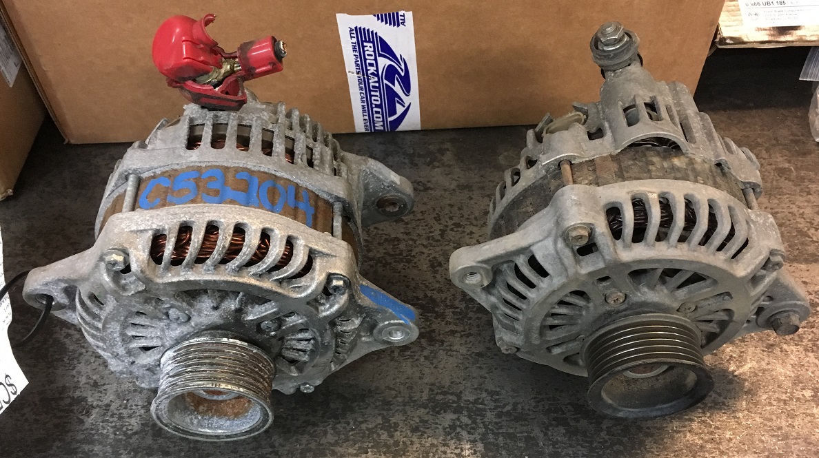

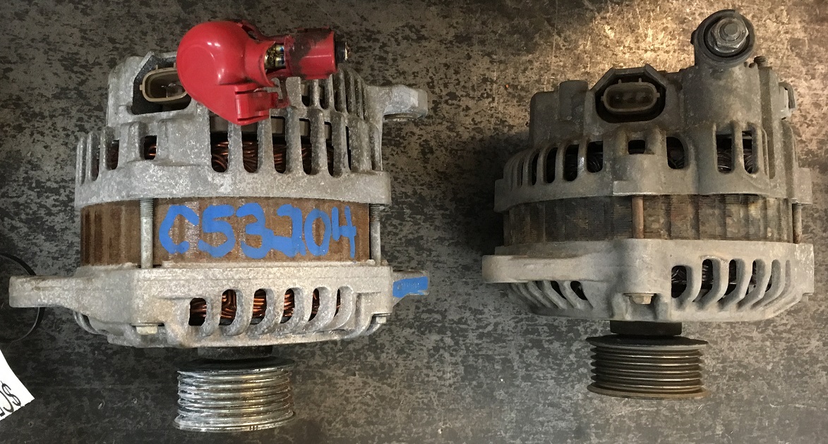

While that was out it made replacing the alternator easier.  The 2015-2017 Outback alternator (on left) bolts and plugs right in but puts out 130 amps vs the 2002 Outback 100A alternator (according to Rock Auto).
We can now run all the lights and the AC at idle and maintain 14V.  With the old alternator it would drop below 12V with the AC and all lights on even at 3000 engine RPM.  Nice upgrade for $80 and we now have a good spare alternator again.

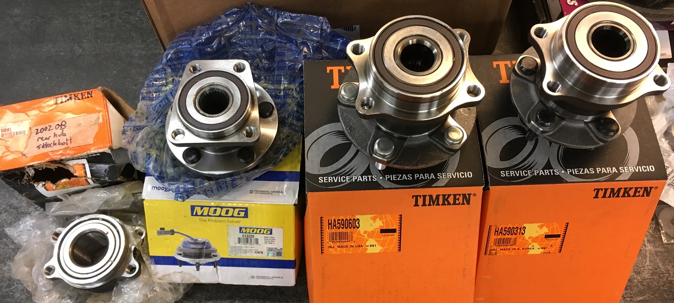

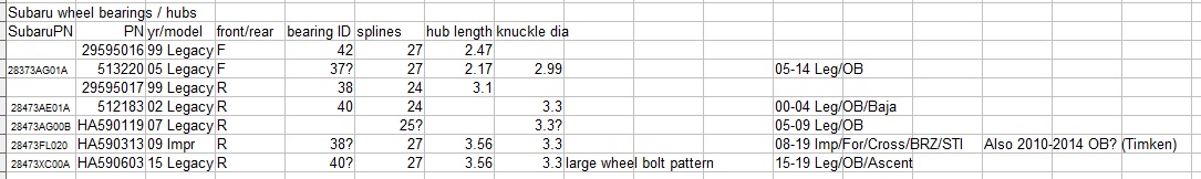

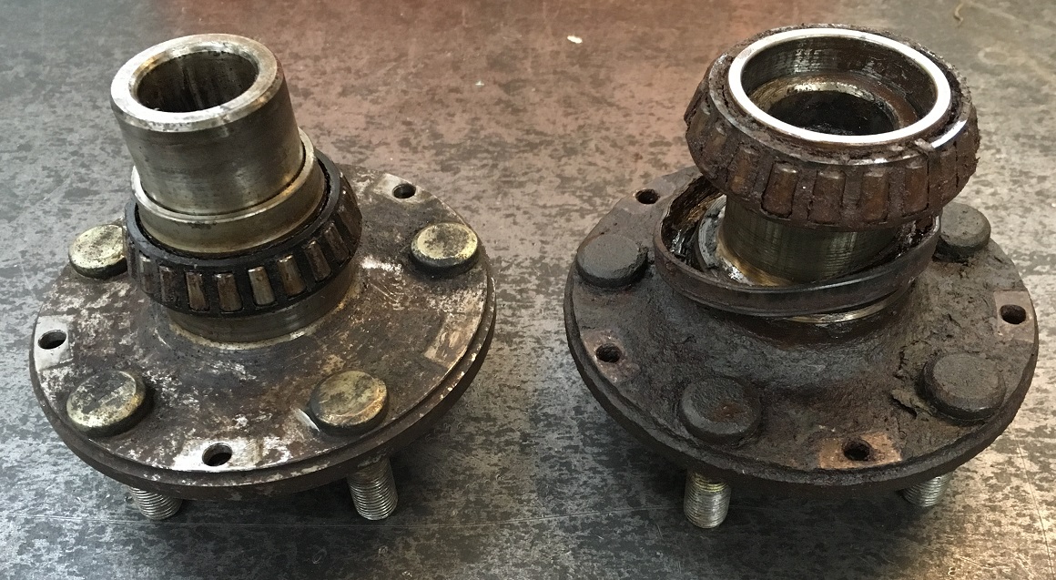

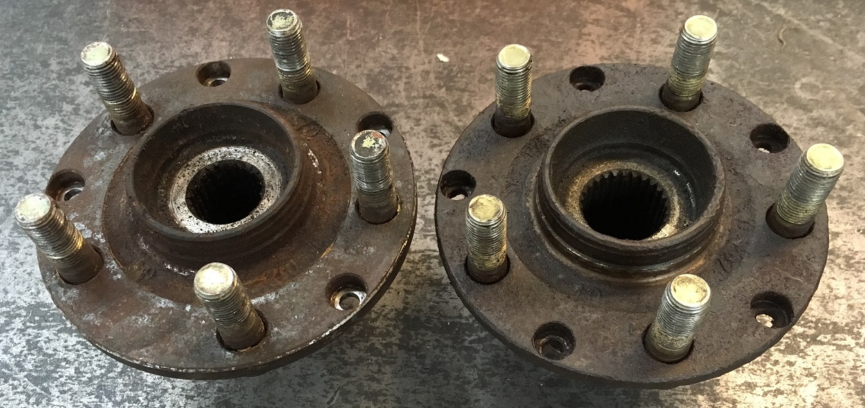

Been wondering for a while now if we can fit the larger front axles we've been using on the rear somehow.  Got a couple later model Subaru wheel bearing/hubs and took a bunch of measurements.  Left to right - bolt on rear wheel bearing 2000-2009 Legacy/Outback, bolt on front wheel bearing 2005-2015 Legacy/Outback, bolt on rear wheel bearing 2015 Outback (2015+ Legacy/Outback/Ascent), bolt on rear wheel bearing 2009 Impreza (2009+ Impreza/Forester/BRZ, according to Timken/Rockauto this also fits 2010-2014 Outback).
On the left is the press in wheel bearing style hub for the rear of a 99 Outback.  On the right is the front press in style hub for 99 Outback.
Here are the measurements we came up with:
Bearing ID is in mm, the ones that were pressed together I just guessed at, can't get an exact measurement.  Other dimensions are in inches.
Don't have a rear hub for a 2002 handy, the only place I could find to buy one new was the dealer at $160, haven't gotten one out of the spare suspension we have lying around.
Should get one for 2007 Leg/OB, didn't realize that one was different until I started typing all this up, specs on that are from Timken, not sure about the 25 tooth spline.
15 Legacy/Outback rear hub has a much larger wheel bolt pattern than the rest.
The later model bolt on rear wheel bearings do have the same 27 tooth CV spline as the front hubs.  All of the rear bolt on wheel bearings seem to have the same knuckle diameter but they all have different bolt patterns at the knuckle.  Also the late model rear hubs are much longer than the earlier hubs.
For the multilink rear suspension I think the easiest solution would be to press a hub out of a 2005 front bolt on wheel bearing and sleeve it to fit the 2002 bolt on rear wheel bearing.  That might even fit the rear press in wheel bearings on the older cars but the outer seal would be a problem.  Then we could make up some splined stubs to go in the rear diff to use the female style axles.  Not going to happen any time soon, just thinking about our options in the future.
Edited by pontoontodd
Awesome Todd!
Good to know about the spline change from 00-04/05-09.  I knew the bearing and rear suspension is all the same, but I guess the hub and axle are different.  Won't matter for my setup as I will be pulling axles and wheel bearings as a complete unit when I swap them.
I like the idea of cutom stubs for the rear diff is cool.  I'd like a set for when I T-case my wheeler.
I still don't get how the length issue of outer splines will work out.  Seems like fronts would be too short to go through the entire hub.  I'm sure if there is a way, you'll work it out.  Keep up the awesome research.  I couldn't have done my project without some of the info you've provided in this mega thread. Thanks.
3 hours ago, FerGloyale said:
Awesome Todd!
I'm not sure about the 05-09 Leg/OB rear hub spline, hard to believe it's a different spline than all the others.
The 02 Leg/OB bolt on rear wheel bearings are only about 1/2" wider than the 05-14 Leg/OB bolt on front wheel bearings.  That's the width of the spacer we've been using on our front CV axles/bearings with the longer front control arms, so it should work out fine.  At this time it would be a lot of money and time for the benefit so I don't plan on doing it yet.
You're welcome.  The rock crawling/bouncing you did recently was some of the most extreme I've seen a Subaru do.
Would it be any easier to make an adaptor for where the bearing assembly bolts to the hub?
07 outback front:
07 outback rear:
Thought about making an adapter, I think it would be easier to just use a different hub, maybe turn up a sleeve if needed.
rear outer splines are the same between '00-'04 and '05-'09. I used an '05-'09 rear hub assembly when I needed a rear bearing on my '00.
This is relevant to my interests......Both 6-cylinders?
Thanks on the spline info.  Did you get a new 05-09 rear hub assembly?  If so did it come with the hub pressed into the bearing?  The one I got for a 2002 is just the bearing, can't buy that hub except from the dealer for $160.
Yes, the alternators were both from six cylinders (EZ30/EZ36).  Looks like it would fit on 2000+ Forester EJ25, pulley might be wider on the six but might still work.
I had thought this to be the case too.
Hmm.... i wonder if the timken Specs are referencing splines of hub vs. splines of the axle stubs, Peaks vs. Valleys and such?  24 peaks, 25 valleys?
Edited by FerGloyale
Yep. '05-'09 has the hub built into it. I thought this was interesting, the '05-'09 bearing (SKF anyway) and flange were bigger than the '00-'04.
20181222_062947~01 by Numbchux, on Flickr
I bet you'll find that hub from the dealer is superseded to a hub-bearing assembly, too.
I'm not sure what specs you're referencing. Timken doesn't make anything with splines for a '00-'04 rear, it's just a bearing in a flange, and the hub is reused.
Splined hubs & stubs are always counted on the major diameters.
