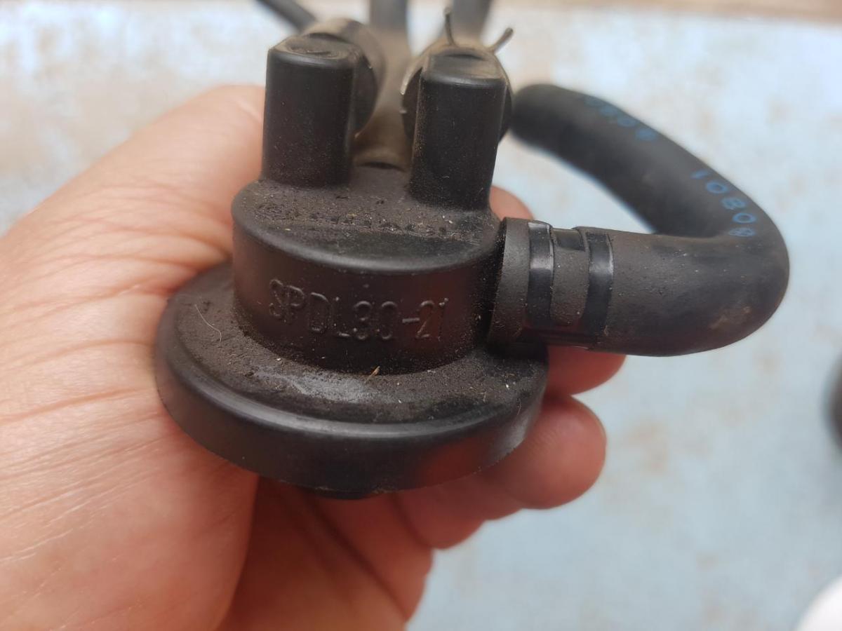

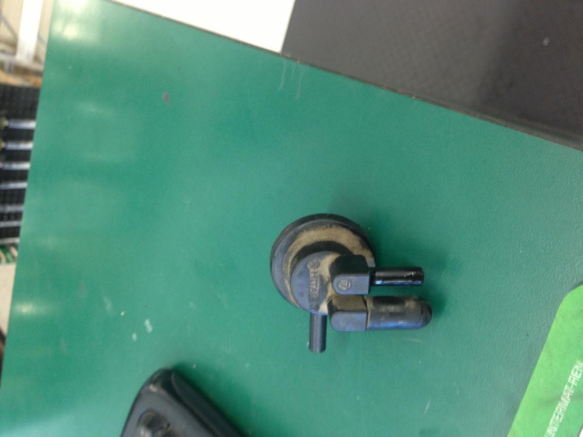

post-65630-0-15396200-1510271933_thumb.jpgI think I have figured out the item giving me the problem, it's the Air Control Vacuum Valve. I noted the item number on the part, Hitachi SPDL30-21. The c=valve has 3 hoses connected to it, 2 on top, one on bottom. The bottom piece broke off so now it is no longer connected. I capped the hose and put a temp cover over the hole in the valve and that seems to almost fix the issue, still happens on rare occasions, not like before.
So, I need to replace this piece but I can't find one online. I may end up trying to glue it back together if I can't find one. Any idea's where I could obtain one, or does anyone want to sell me theirs?
Here is a pic I took from another users post....
