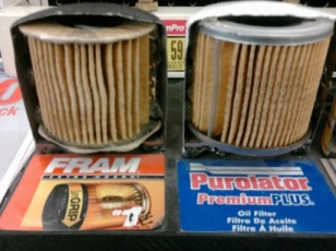

October 17, 200916 yr i got a picture to post showing the guts of a Fram. you can see the cardboard end caps, they're even flimsy just sitting there with no oil on them. if they're willing to make something that cheap on the inside and put their efforts into mass marketing instead of quality, i'll pass.
October 17, 200916 yr Nice Pic Gary.. I have tried to explain this concept to people and they dont want to listen..but that picture says it all.
