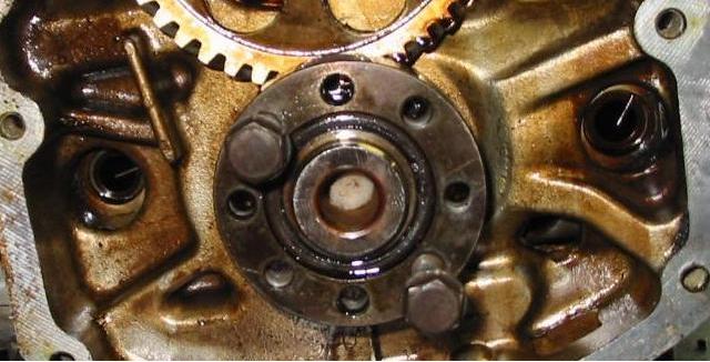

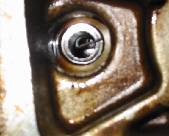

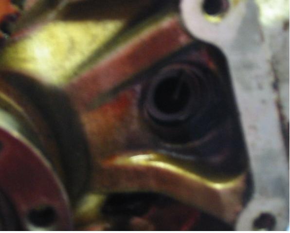

so american ea81's have 4 gudgeon plugs? nah its just that 14mm allen key is not a standard size in Australia and no good tool shops are open on Sundays (today) or Public Holidays (tomorow) so i have to wait till Tuesday to get one. So I was trying to make do with what I had and failed miserably.
Yeh those photos where taken with the flywheel housing off and engine up side down heh and i even lined up the pins for ya. Damn its a beetch trying to upload photos resizing n such.
No just the two on the front of the engine. It's the EA82 and later engines that have 4.
