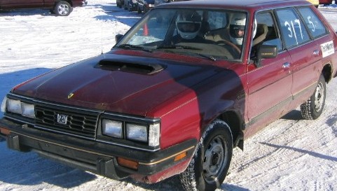

It's the ultimate winter-beater, an '84 Turbo with a pushrod 1.8L.
Upgraded turbocharger (dual ceramic ballbearing)
In cab adjustable variable boost controler (11psi).
Bosch blow-off valve
Intercooler with custom heat shield and custom intake piping.
2.5" SS custom downpipe.
2.5" SS mid-pipe and muffler
Stainless steel header and up-pipe.
RS style fiberglass hoodscoop.
5-speed conversion with 3.90 rear diff.
We hope to cage it soon for rally. We're warming up doing the local Winter Autocross Series. In the first event I believe it finished 4th behind a Mazda GTX, an Isuzu Impulse, and a WRX.
See below for more photos.
Any comments?
Keith

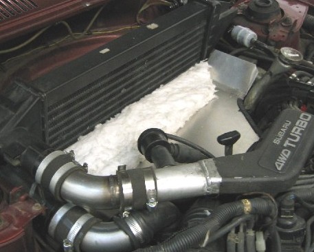

Under the hood!

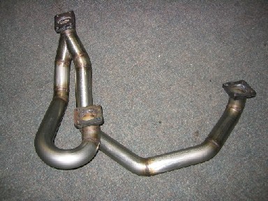

Stainless Steel Header

That is beautiful! I was thinking that when i make my own, I will need to get the driver's side pipe really short, or make the passenger's side long because I would want an equal length header. Any chance of you making one of those for little old me?

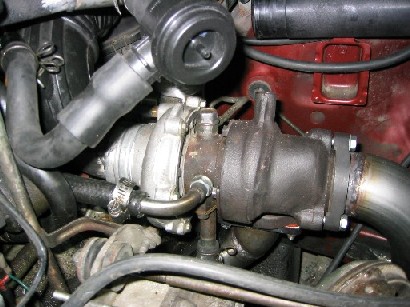

Upgraded Turbocharger
You can see we had to perform several modifications to accomodate the different turbo, including a different downpipe flange, different oil lines and a changes to the inlet and outlet.

It's not within .10" like our Impreza header but the header is actually very close to being equal length.

like how close are the runners in length?

Did you keep the old intake? And if you did, did you remove the Air Relief Valve?
Rob

I will have to check with the designer for the difference in the lengths. He is lecturing to an engineering design class this evening. Can you wait until tomorrow? I'm interested to hear what other mods you have planned, especially the more extreme ones.
Turbone
Again, I'll check with the designer/fabricator to see about the air relief valve. You might be able to see it in the Under the hood shot or Snocross10c.

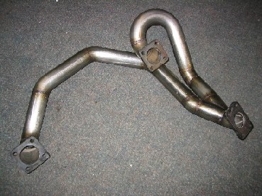

Here's another view of the header.

keith, Sent you a PM. How does that turbo work for you? not too big for the engine is it?

You'd be surprised at how many people think that is snow. It is actually a ceramic wool sheet placed between the stainless steel heat shroud and the intercooler to further isolate it from the heat of the turbo.
Everyone, thanks for all the positive comments. It's Tom's car and he did all the work.

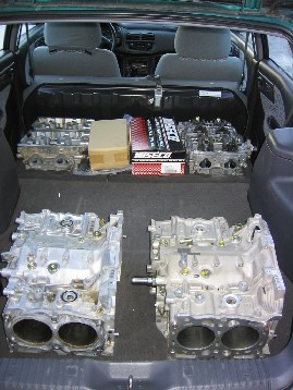

Now I'll really confuse you with my 6.9 Liter OBS!
You have to look at the photo closely to do the math.
Heading out to the Cryo facility earlier this week.

Let's see there is an EJ22 under the hood. A EJ25 block and a EJ22T block on the back. So that 2.2+2.2+2.5 = 6.9

Nope, cant see it in any of the shots, alot of mods in the engine bay. Its kind of buried behind the manifold and under the plenum.

in the turbo pic that looks alot like a saab b.o.v or at least a bosch one
well that and a ceramic bearing turbo would be cool to have
how well does that intercooler work set up like that
seems like it would not get alot of airflow
but then again i did not study the pic very close
