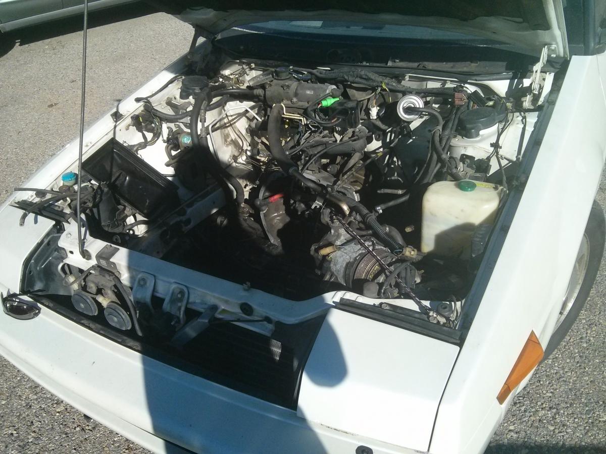

"Icarus" 1988 xt6 build

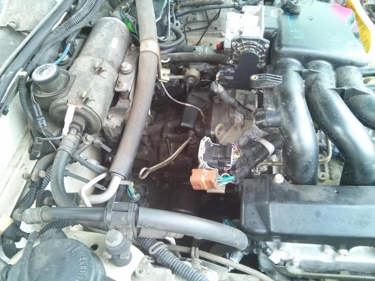

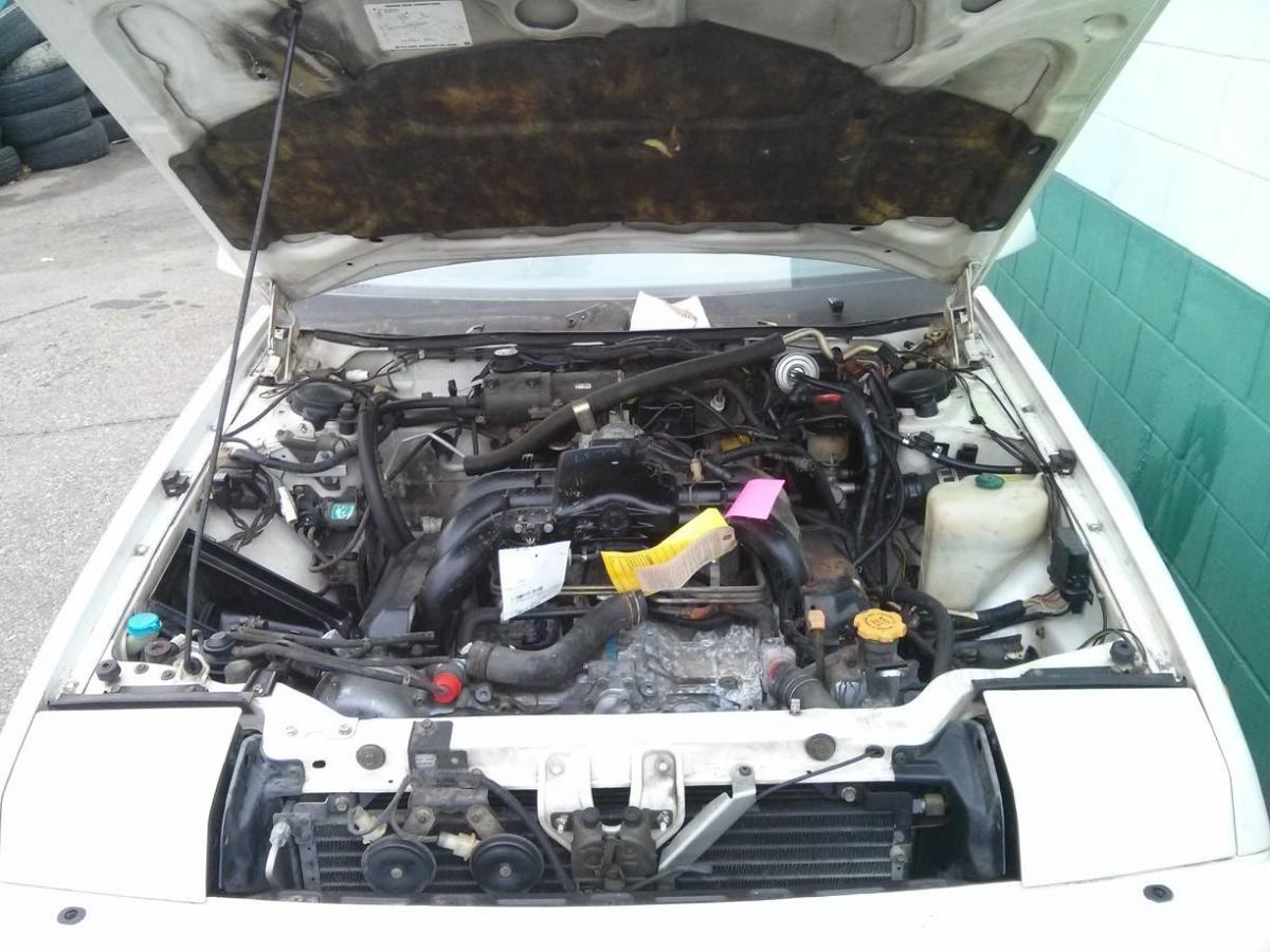

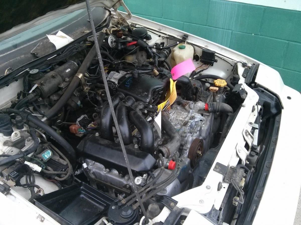

Engine is in place, and the last of the various parts are being connected as best as possible. Steps remaining: -Cutting out part of the hood sub-structure to allow room for the intake manifold (it's a bit too tall currently....) -Placement of alternator -Wiring/engine management -Exhaust -Rear drive shaft. And Drive! It's almost winter here, so I'm just going to leave the A/C system until the spring.

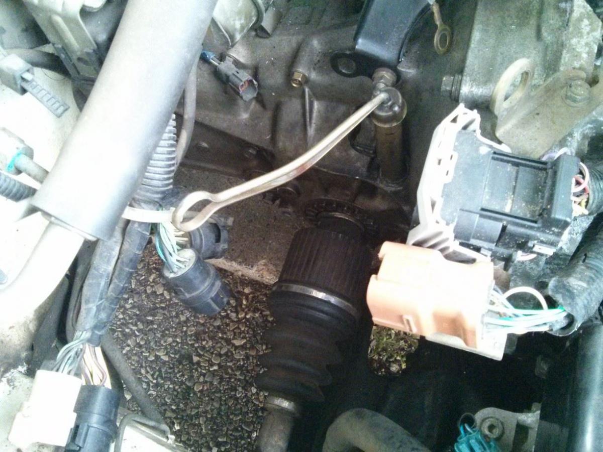

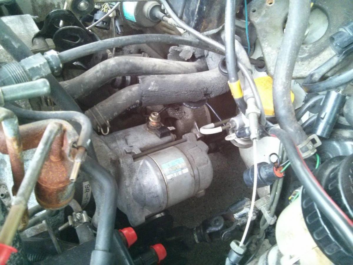

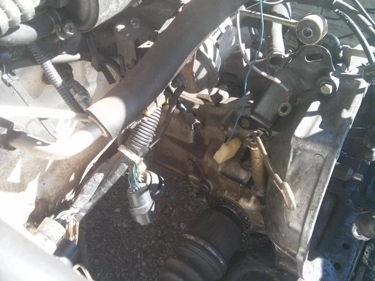

As we stand, the transmission, franken-pedals, and clutch parts are all sorted and installed, and the engine is waiting to be installed. A side note on the clutch setup, I was originally going to use a Hydro, pull-style clutch. BUT apparently there's no room for the Master cylinder/hydraulic pedals parts in the XT6 foot-well area. SO we ended up building a pull-style, cable actuated system...we'll see how that goes... I've already discussed the exhaust setup with a place nearby which should run me ~ 1250$ but would include everything (including Cats) back from the exhaust header manifolds. I'm grabbing a set of SVX exhaust headers from a fellow on http://www.subaru-svx.net/forum/ it's interesting that the SVX and EZ30DR have the triple port system (Dunno if that's the right term, but I'm talking about the exhaust header design) while the EZ30D only has the single...I wonder why Subaru changed it for that particular engine. But for all who might read this, I'm in need of some Air-ride parts....the other fellow I was talking to about his parts hasn't gotten back to me in quite a while, and I'm going to need a computer and sensors at the VERY least, potentially struts...so if anyone has bits kicking around (I'm looking at you Gary) give me a shout! Oh, and I'm going to have to mount up that Kaminari spoiler as well.
