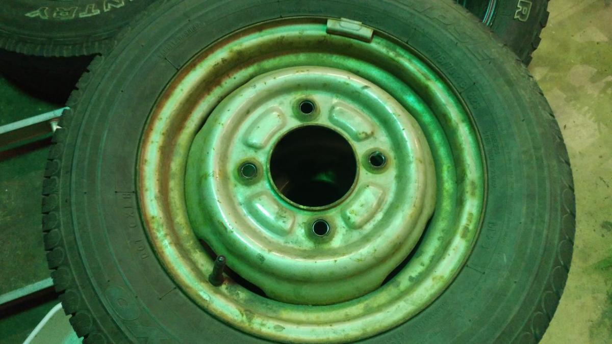

five! (5) OEM 1977 Subaru Coupe 4x140 Steel wheels, First gen ( EA71 ) 4.5" backspacing harder to find smoother steel pattern. 4 are 175 70 13 Toyo Eclipse All Season tires, Spare painted flat black, 155 85 13 Toyo Eclipse, matched tread spare. All have Very good tread, see pictures. 250 OrBestOffer, Located in Sandpoint, ID. Discount for forum members, better discount if you want them for a coupe. https://spokane.craigslist.org/wto/d/5-subaru-wheels175-70r13-toyos/6338105085.html

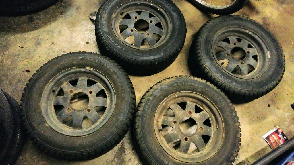

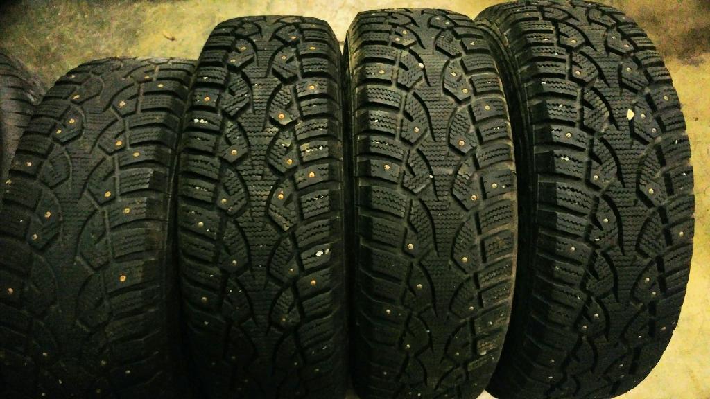

I finished my 6-lug conversion. No longer need these. For Sale 4 OEM 1978 Subaru 4x140 wagon wheels, First Gen ( EA71 ) offset. Will fit 70's -90's GL, DL, Brat, Wagon, and Loyale, all 4 lug subarus. Coated black, 175 70 13 studded General Arctic winter tires. 2 are excellent condition, 2 are slightly used, see pictures. 200 obo, Located in Sandpoint, ID. I will likely be selling my stock Steelies from my 77 formerly FWD Coupe as well. See craigslist advert, or message here. https://spokane.craigslist.org/wto/d/first-gen-subaru-wagon-wheels/6335274090.html

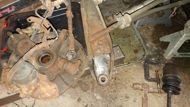

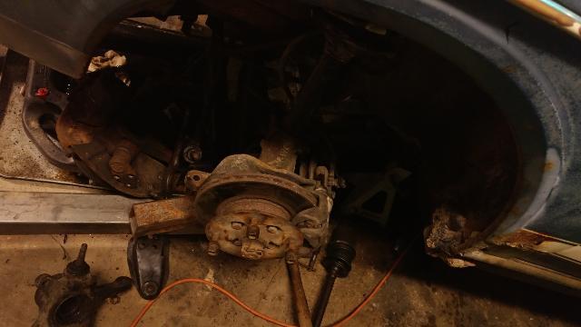

I only had to fabricate 1 part, the strut top spacer, and did have to cut and modify the Lower A arm attachment, as seen in picture. It lined up much better than expected. If anyone has interest in this, I can write up a breakdown.

Tie Rods done. The EA82 items, do In Fact bolt up to the EA71. All I have left is to find someone near Sandpoint, ID that can blow the two 4 inch holes in the steel plate for the strut spacer bottoms. Anyone have a torch and want to help?

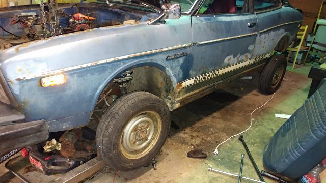

Just for a giggle, "Can't" isn't in my dictionary. Here are some pictures, works so far, have to finalize and weld in the next week or two. Only thing I dont have yet is the Tie rods done... Mostly due to rust sticking the ends on.
