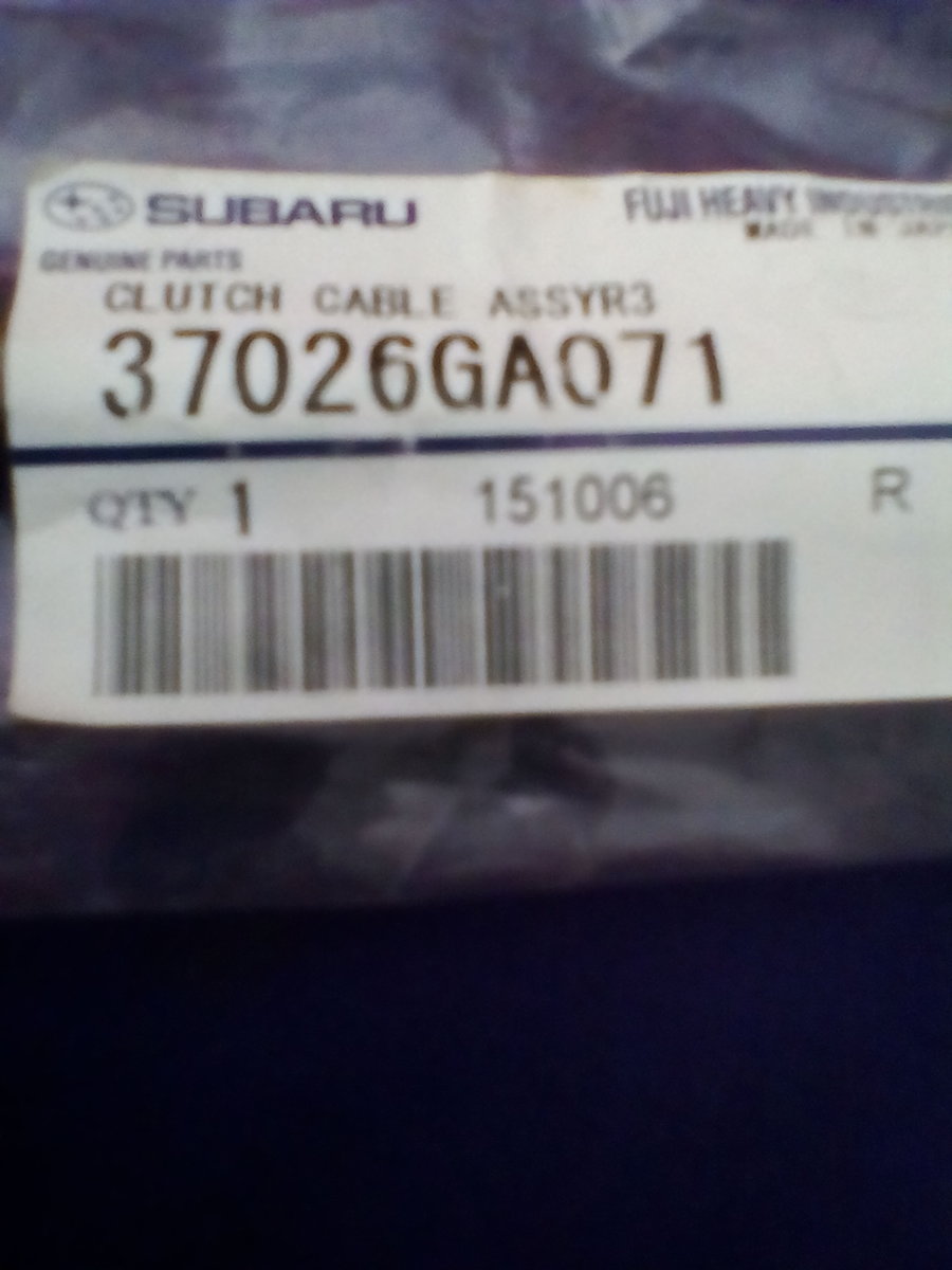

Clutch pedal very hard to start pushing in...
Steptoe replied to idosubaru's topic in Old Gen.: 80's GL/DL/XT/Loyales...
Rae, good idea - great minds think alike my dealer, when trying for another component, no, actually, same item, just different model, Googled the genuine part number and found a UK parts company listing it When I placed an order with them, I only helped them audit their catalogue - nil stock Once upon a time we had people who could make you a new cable, copying what you have, possibly using outer cable ends A specialist brake and clutch place is a non cyberspace place to try after Google for both UK sources or custom make -
