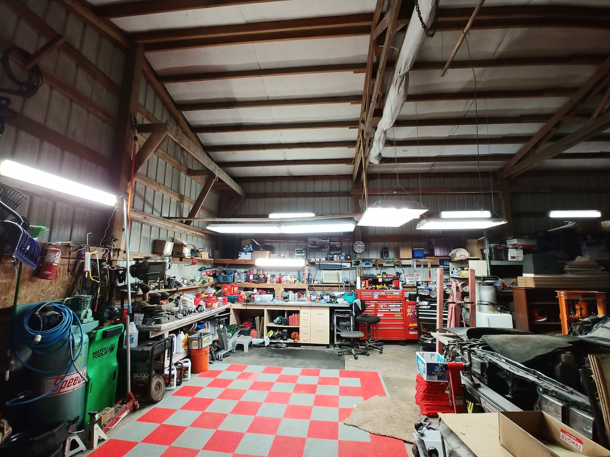

Ohhh, did someone mention lights? :D
The ones high on the back wall are still florescent, the rest are LED
Cant have enough light when your eyes are getting old
