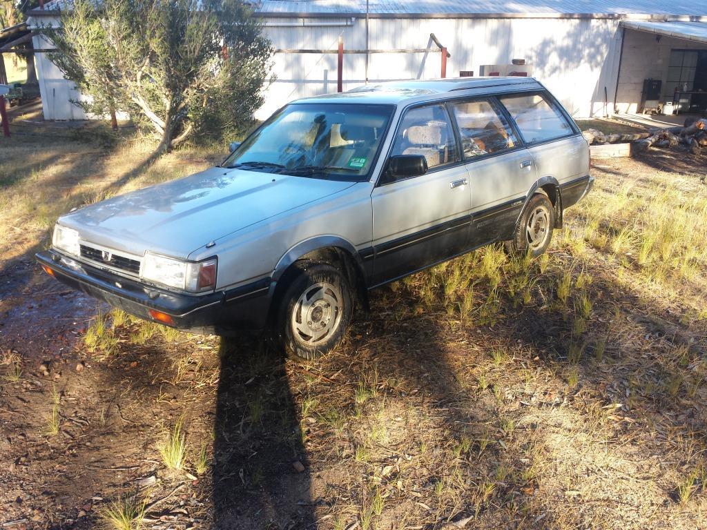

Didn't do anything to mine, but drove 1400km round trip to inspect a possible donor car.
1990 JDM (import to Aus) GTII touring wagon.
Spec won't be too much surprised to US, but things that Aus wagons don't have that this one does:
Digi dash, cruise, headlamp washers, front fogs, variable intermittent wipers, 4EAT, EA82T
The engine has typical blown head gasket, but the body & interior are rough.
Deciding whether to "kill" it for parts for mine, or fix it a bit with my parts (NA MPFI + dual range 5 spd) and use the good bits in my shell, or flog mine & "restore" this one.
