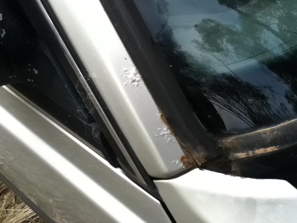

coxy Posted September 5, 2015 Share Posted September 5, 2015 Cut and Tig weld new sections in is the only way to sort that out, Minimal distortion and you don't have to strip as much and unlike a Mig weld no chance of weld spatter on any glass as the best bonus. Quote Link to comment Share on other sites More sharing options...

wagonist Posted September 6, 2015 Share Posted September 6, 2015 coxy, you know anyone who could do that work? I don't know how to weld and this wouldn't be a good place to learn If I can buy it though, the seller's become a bit elusive... Quote Link to comment Share on other sites More sharing options...

KiwiGL Posted September 10, 2015 Share Posted September 10, 2015 coxy, you know anyone who could do that work? I don't know how to weld and this wouldn't be a good place to learn If I can buy it though, the seller's become a bit elusive... Those A pillars don't look too bad. Once you take the windscreen out you'll have a better idea of the scale of the problem though, mine had rusted down behind the spare wheel well and behind the front mudflaps too - the front end wasn't held on very securely. But mine looked worse than that! Difficult situation owning two... Quote Link to comment Share on other sites More sharing options...
wagonist Posted September 11, 2015 Share Posted September 11, 2015 After joining this forum, I've realised that Aussies get not too bad a deal when it comes to rust. We only get it around the screen (and then only due to poor workmanship when replacing it) or around damage. I've decided to buy it. Got enough to make 2 complete cars, so I'll see about repairing the rust & fixing it after I get mine on the road. The rest of the car is tired, but not too bad. How do you go with replacements parts over in NZ? Getting thin on the ground in a few places here now. Quote Link to comment Share on other sites More sharing options...

coxy Posted September 13, 2015 Share Posted September 13, 2015 (edited) Wagonist there is a guy down at Darkes Forest south of Helensburg who would probably be the man to see to fix the rust properly see the link, He will fix it properly, have a look at his site this guy is no typical modern slap em together so called panel beater such a good basis deserves fixing properly and I do believe this would be the man to do the job. http://www.lonestarbodyshop.com.au/default.php As for L series bits there are two choices the Subaru wreckers at from memory Cardiff near Newcastle and Dapto Pick a Part as it seems older model anything is scarce in Sydney these days, there are a few wagons at dapto plus earlier stuff and compared to Sydney prices are pretty fair. Dapto sells any gearbox in the yard for $250.00 which makes the many Foresters and Impressa's and Libertys a bargain for a second hand box and I prefer yards where you pull the parts rather than off the shelf stuff because you can see the cars condition and judge how well it was looked after, For instance an engine that whilst dirty and with some evidence of oil leaks tells you it was a runner before the accident wheras I have been caught twice with so called Reconditioned heads that had cracks. Seems some wreckers will have a head serviced and put it on the shelf but neglect to have them pressure tested to make sure there are no cracks, So when I come across one that is dirty and was obviously still in service till the accident I know the odds are much better that is is useable with no cracks. Oh I suppose I better add something I have done to My Subie lately, Fitted a touring wagon tilt column to the brumby mainly because the ignition switch needed replacing and this one was low miles and the switches are different so required the column, Got a full matched set of locks and paid ten bucks extra to get it with the column and all the surrounds required, Dismantled the Ignition switch and cleaned and serviced it just to make sure that the tumblers were all good as my old one was getting pretty worn after 450,000 km, The new one is 310,000 km younger Edited September 13, 2015 by coxy Quote Link to comment Share on other sites More sharing options...
