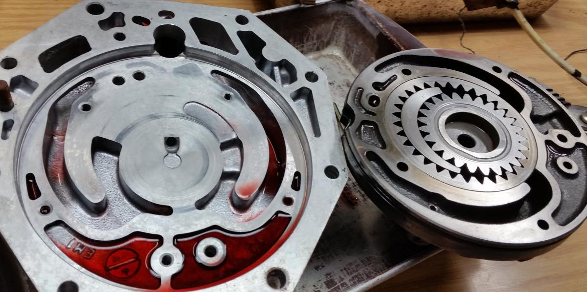

I have now removed the transfer section and oil pump from 2 of my 3ATs. Removed most of the gears and clutches from a 3rd. Except for the stupid oil pump drive shaft input splines, so far, nothing else looks bad. Hard to believe all of these have 150,000 to over 200,000 miles on them.

I found out why the 1993 transmission lost reverse and 3rd. The release servo tube fell out, and was sitting in the pan. Checked the flow diagrams in the FSM, yep, that would do it. I could have fixed that on the car, BUT I would not have found the pump shaft spline wear. Seems to me there should be a little clamp / clip to hold those tubes in place. There's a bolt right near each of them anyway...
There is a little wear in that you can tell it has been turning, but not what I think of as scoring. I'll see if I can get a decent picture.

Started dis-assembly of the 1990 3AT. So far, the only thing that looks wrong is the stripped spline on the pump drive shaft. Even the spline on the pump looks good. This thing has over 200,000 miles on it, I've driven it since it had 15,000 miles.
