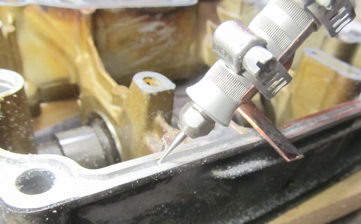

I use the OEM reenforced o rings for the oil passage also. What I am referring to is the groove in the cam carrier that is usually filled with the anaerobic sealant.

Oh, good. Thank you! I really didn't want to have to be delayed and re do it. The engine I reassembled a month ago, I had more time with, and got fancy. I used my dremel to widen the groove enough to fit o-ring cord into it. It sealed up nicely!

Last night, I assembled the cam carriers to the heads on an EA82 engine. I used the Permatex anaerobic gasket maker and surface prep activator. The exposed stuff that oosed out of the joint when I tightened the bolts has still not set at all. Is this normal? OR What went wrong?
