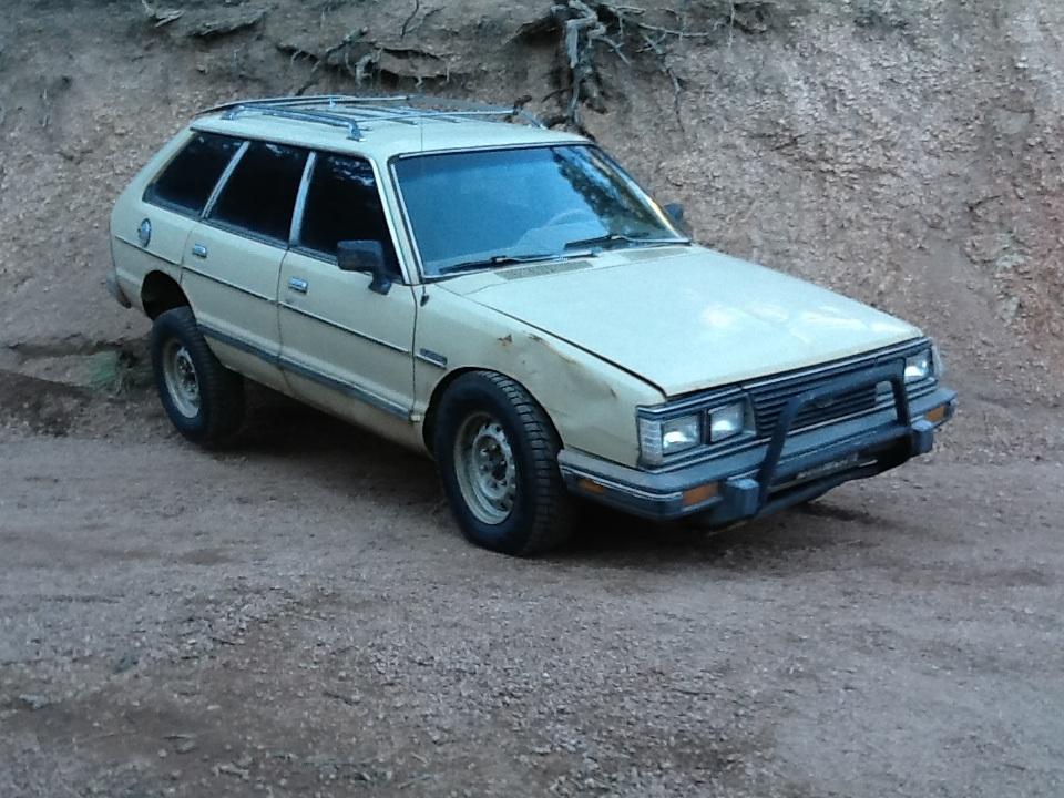

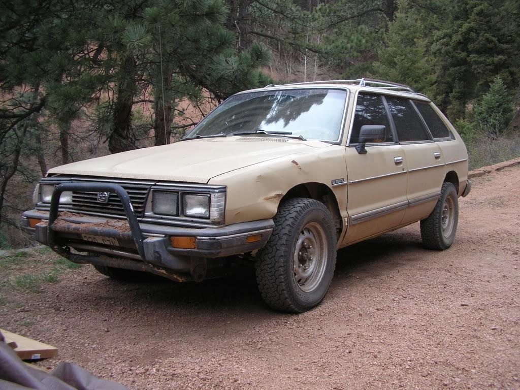

Heres mine. Ive posted these before, but whatever. I cut 1.5" from the rear, and 3" from the front using just a sawzall. Measured carefully and drew it out so it would still look somewhat normal, and not like somebody took a sawzall to it. The rear has several layers, so i riveted them back together after the cut. These pics are with 195-75-14 BFGs. Its now sitting on 205-75-14s, and i had to massage with a BFG, the reinforcement rib that runs through the front fenderwell to fit those. And no lift! -
