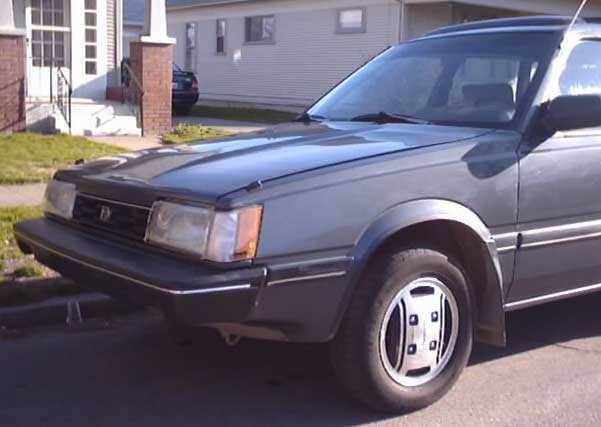

  14. what a neat looking EA81. i like those mirrors on the fenders. seems to me i've seen the fender turn signal somewhere before, though
