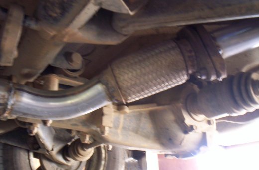

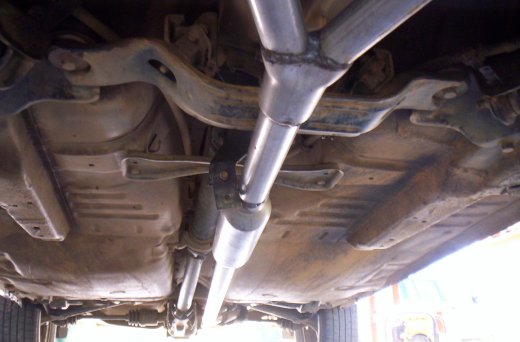

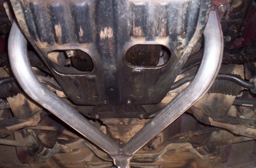

Looky... Looky...My new Exhaust (with pics)
ausubaru92 replied to ausubaru92's topic in Old Gen.: 80's GL/DL/XT/Loyales...
It would probaby be closer to $7K, i was told a story of a guy with a V8 who had twin exhausts with no cats, $14,000 Fine!!! I had the exhaust shop bend the pipes where i wanted when i bought the pipe and then i brought it home, I cut it to length and welded, it was realy quite simple. If you can get a hold of a piece of flex exhaust (shown in picture) it makes for any mistakes in your bends or welds. IT DID FOR ME:lol: I think im gonna go for a 2.5" Tip, it will lower the sound and make it look better in the gap in the bumper -
the Muffler and hotdog were both straight through, ie. i could see right through them. the muffler was $90 and the hot dog was $45 Without the hotdog it was noisy and raspy, with the hotdog it is nice, just a mellow gurgle,... -
Overall power is increased, (i change back to 4th gear less often on hills) Much better low end,.. Yeah 1 & 3/4" equal length pipes from heads joined in a central collector with the volume of each pipe being 0.9ltr, then 2" from there on with a hotdog and Mercury Hi-flow muffler. Cataletic converter soon (don't wanna pay a $14000 fine) Welded myself with a total cost of less than $200 ($500 quoted price at exhaust shop)
