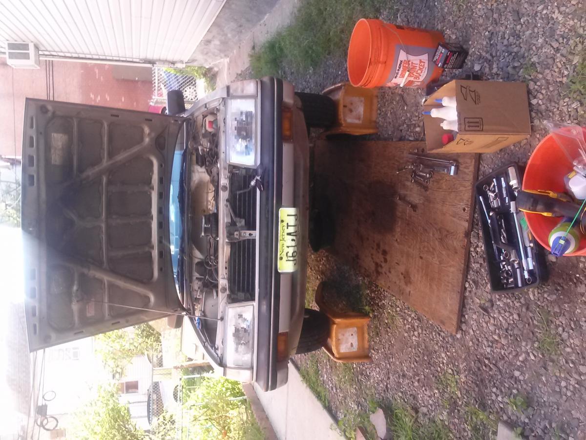

I finished my valve adjustment.. Took my a little longer since I wanted to clean the covers before reinstall.  I double checked each one after adjustment so they should be spot on.  I have got to figure out why I have lifter noise on one side.. It's gonna drive me crazy.  I had it before valve adjustment and still have it..  I did find one intake a little loose and one exhaust was too tight (same area the noise is coming from).  Wonder if it will resolve itself with a little driving?
I guess I will ask in the regular forum.
