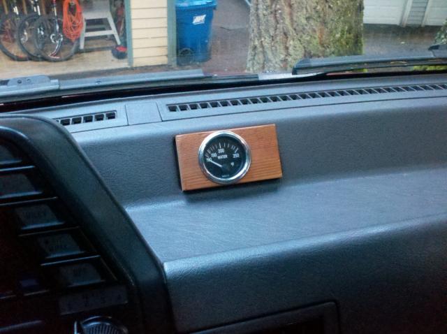

  21. The best thing I ever did to the dead clock hole was an EJ22 swap...then I found a nice place for my aftermarket temp gauge. Yeah I have read about the resistor thing to get the temp gauge to work...but that doesnt work if part of your cluster was dead before the swap.
