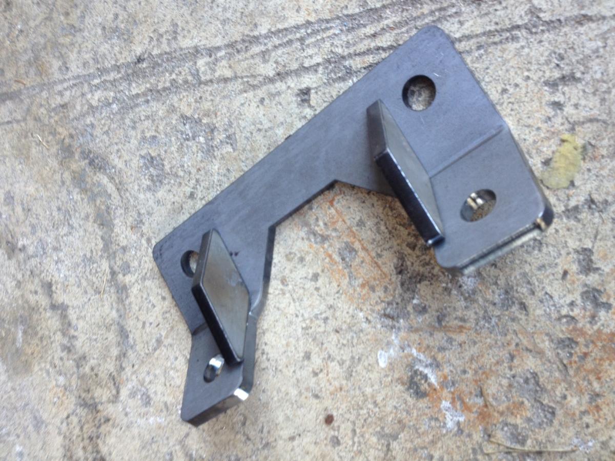

  5. Andersondesign-fab.com Well guys I’ve started building lift kits. All my kits are reinforced and built stronger than they need to be, providing a safe and reliable means of lifting your Subaru. I’m keeping the cost as low as possible to make my customers happy and see them wheeling there Subaru’s! Little bit about myself, I have an AA in Architecture, AA in Mechanical Engineering, my year certificate in machining and almost done with my bachelor’s degree in Architecture. I being working/loving on Subaru’s for over 6 years. Been working under one of the best Subaru mechanics, non-other than GD for over 2 year. On to the Lift Kits! This is what i have currently, I will warranty all my kits and parts them self, as i feel i will never have to, due to the over kill of strength. All hardware is included Kits will take up to a week to fabricate, depending on what i have on hand. And yes this is my original design and my fabrication. LIFT SPECS: All hardware is grade 8 strandard, all metric bolts are 10.9 grade. Top and Bottem hats on the front lift blocks are 3/16" steel, sandwiching 1/4" tube walls. Rear brackets are 1/4" steel with 1/4" gussets. All subframe blocks are 1/4" thickness. When any lift kit is purchased, installation instructions in PDF, along with your Invoice, are included. EA81 2" lift $320 Shipped EA81 4" lift $450 Shipped EA82 2" lift kit $180 Shipped EA82 2" lift kit W/ 1.5" Full sub frame drop $275 Shipped EA82 4" Reinforced rear brackets 70$ shipped EJ 1" Solid steel strut spacers. $200 a set Shipped. The spacers are tapped to allow the spacer to be bolted to the top hat of the strut, for a stronger bond. 98-08 Foresters 95-99 Legacys and Outbacks 02-07 Imprezas EJ 2" Strut spacers. $300 a set Shipped. I also have the 2 Bolt rear for the newer Subarus as well. 2" kits are off set for near perfect caber correction. Forester, Legacy, Impreza EJ trailing arm spacer $110 a set Shipped New Gen EJ $300 a set Shipped 2" SH Forester lift kit with rear trailing arm spacers $500 Shipped FIRST ON THE MARKET!! EJ-EA Adapter plate, 6061 Aluminum wet jet cut. Dowel pins line up perfect and have a snug fit.145$ Tapped,shipped in the US. EJ-EA harness Stripping OBD-1 $250, OBD-2 $200. Before: AFTER: Notes: -All EA82 lift kits keep the camber near stock, if not completely stock. -Wheel at your own risk. -Not liable for any damages not under warranty of ADF. More coming soon! Like me on Facebook and keep posted! https://www.facebook.com/ADNFAB Pm me or contact me at ADNFAB@gmail.com for questions and inquiries!

  16. I was going to hold off on doing this but, I guess I could get a pre order going. I just got my parts back from the machine shop. I've got 2" ea82 lift kits, which includes 2" strut towers, 2" rear reinforced shock tower and hardware. Price is 160$ a kit. Plus shipping I will openly admit I offer a life time warrenty on the kit it self. As I know all of my parts are built for over kill. I'm currently at least a week out of having these done. Pm me if your interested. My goal is to bring a strong, safe, reliable lift kit, that costs less for me to fabricate, which in return costs less for my customers. Photos are my kits, designed in Auto cad by my self. Prwa101
